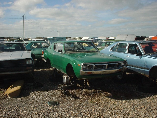

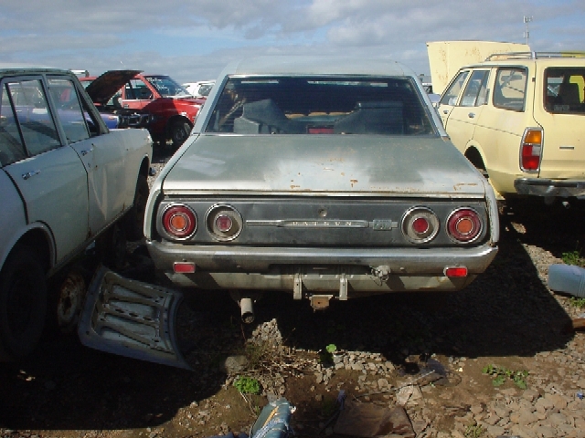

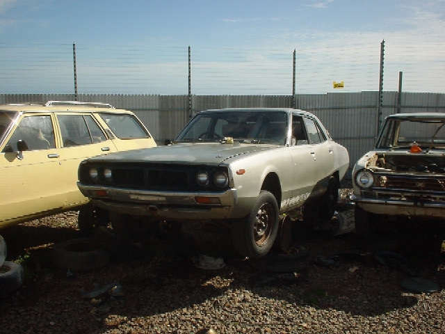

This is a 240K four door from the local wreckers... As you can guess an L24 with a single down draught carby. Not too bad in two door GT form.
Here's the two door
