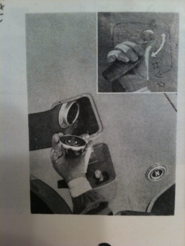

I made a call Mr.Watanabe (PS30-00063 12/69) and he said his 12/69 Z432
has the spring on the fuel door.He guesses Fairlady Zs have a key cylinder for the door (but Z432-R has a knob like an early export 240Z),
so the door is little bit heavier than the knob type.The door has to keep opened position without support, this could be the reason of applying the spring.
But I still have to ask Z432-R and early Fairlady-Z owner about spring, to clear our question which is what makes it has spring due to a key cylinder or car model grade.

PS:attached picture is from an owners manual of Fairlady Z series issued NOV 1969.

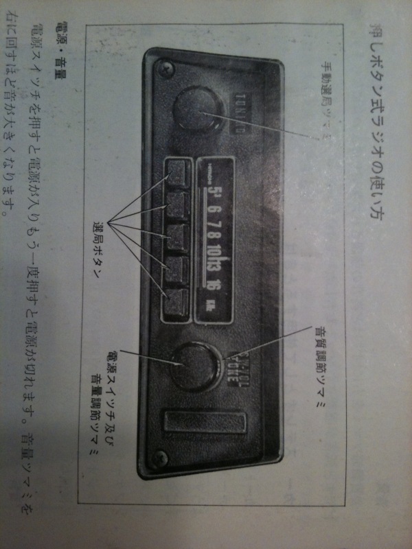

Fairlady Z (S30S: standard model) has a simple radio,it does not have auto matic antenna nor automatic station tuning.See the first picture from the owners manual issued NOV 1969.
