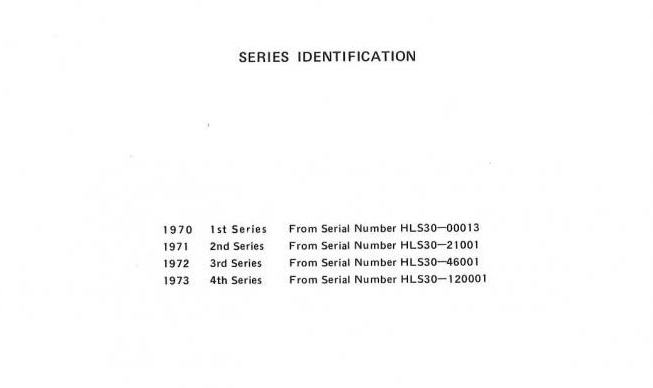

According to Nissan HLS30-46001 was the starting serial number for the 1972 Model Year. This does not mean there were not discrepeancies in how the cars were outfitted.

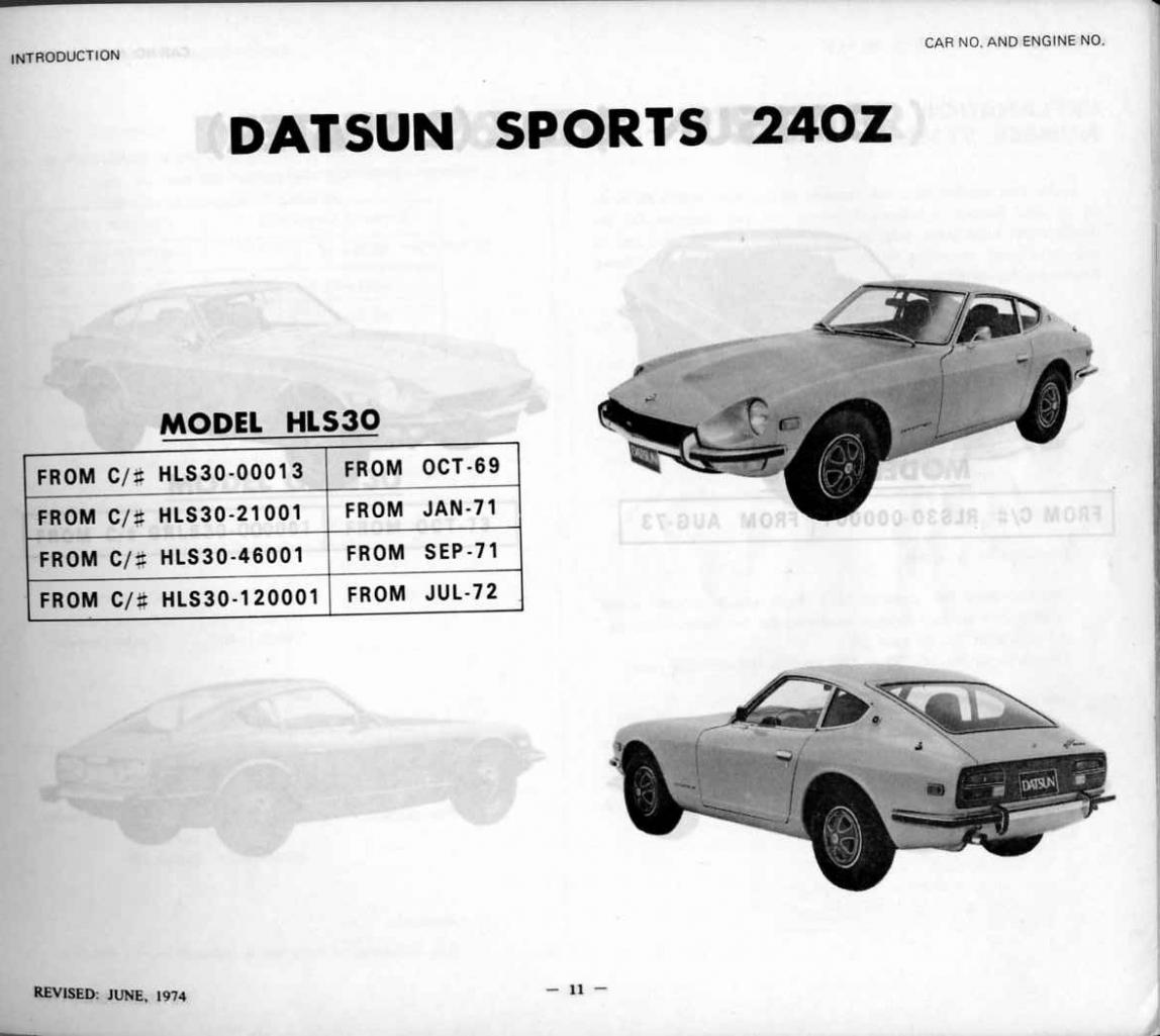

Here are a couple more Nissan documents to support HLS30-46001 as starting VIN for the 1972 model year (series III). It looks like Nissan chose nice even VIN's (000's) to use as starting points for the model years. Although, as Ron noted, there was some parts carry over as some old parts were phased out. Also the cars could be titled differently in different states, by different dealers, etc. Using a starting VIN in the 000's seems much easier than trying to target a specific production date cutoff (first of the month for example).
Rick, what is the closest VIN either side of HLS30-46001 that you have recorded? Zhome shows HLS30-43274 (Escanlon's car) on one side and HLS30-46354 on the other. It seems there may be a gap so that certain VINs prior to 46001 were not actually used in order to provide a proper starting point for the new model year.
