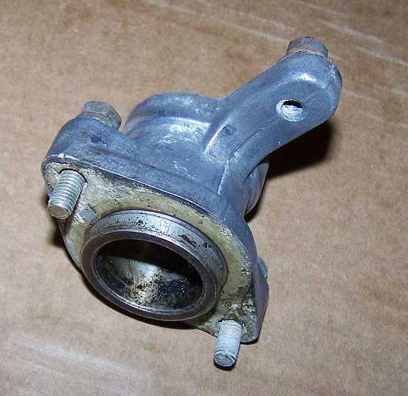

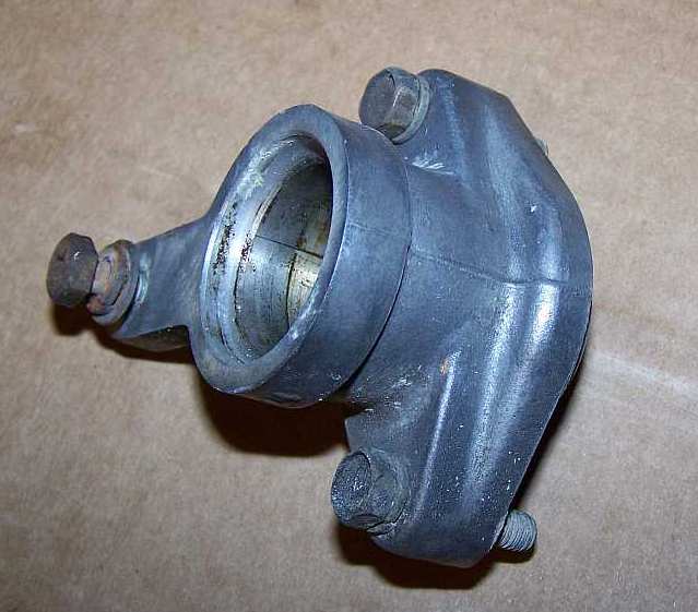

I'm in the progress of installing a ZX dizzy, the dizzy doesen't really match up, with cyl #1, after investegating it a bit, i have found that there is two different kind of dizzy base for a ZX dizzy,, witch one will be the correct to use ?

I think there are at least three different ones. I have my original pedestal, one that was sold to me on another board as a ZX pedestal but wasn't, and the zx pedestal that I subsequently bought.
I have a '79 dizzy and the pedestal that works for me is from an '80 model. Make sure you get the plate also.
The one in the photos is not the same as the one i have, on mine the tab is more like 10-11 o'clock, your's looks to be 9 o'clock, i do have the plate, it was on the NOS dizzy i got.

Andy, i know of that site and that was one of the things that made me believe i got the wrong base, but what about front cover, i have no idea of what kind i have, do different covers demands different bases ?
It's the one at the left i got.

Mike, that one looks all wrong, do you know where it coms from ?
