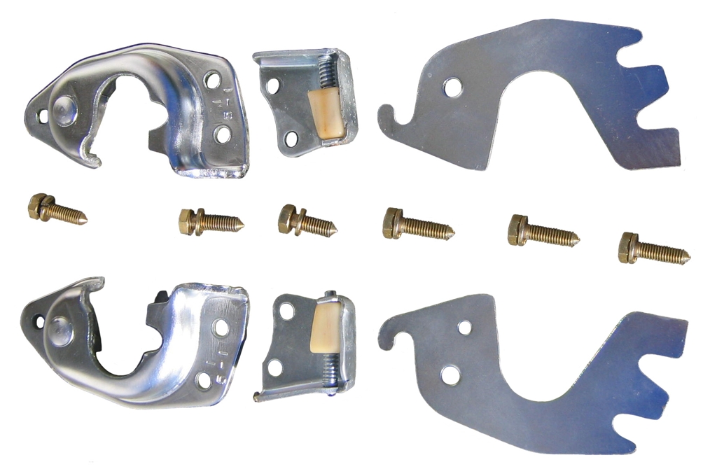

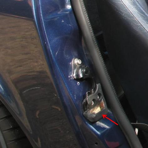

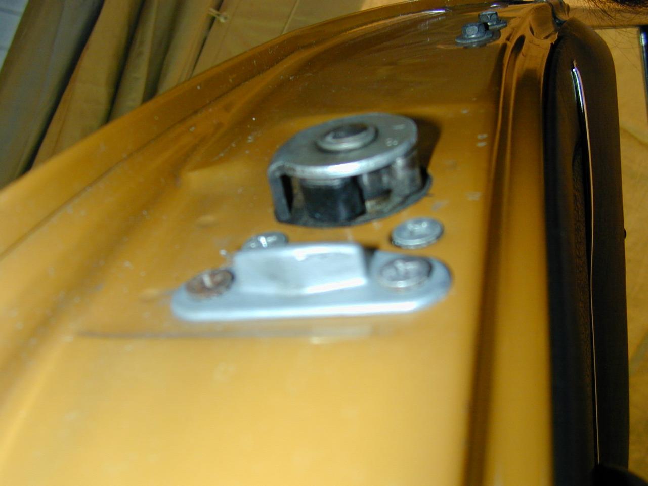

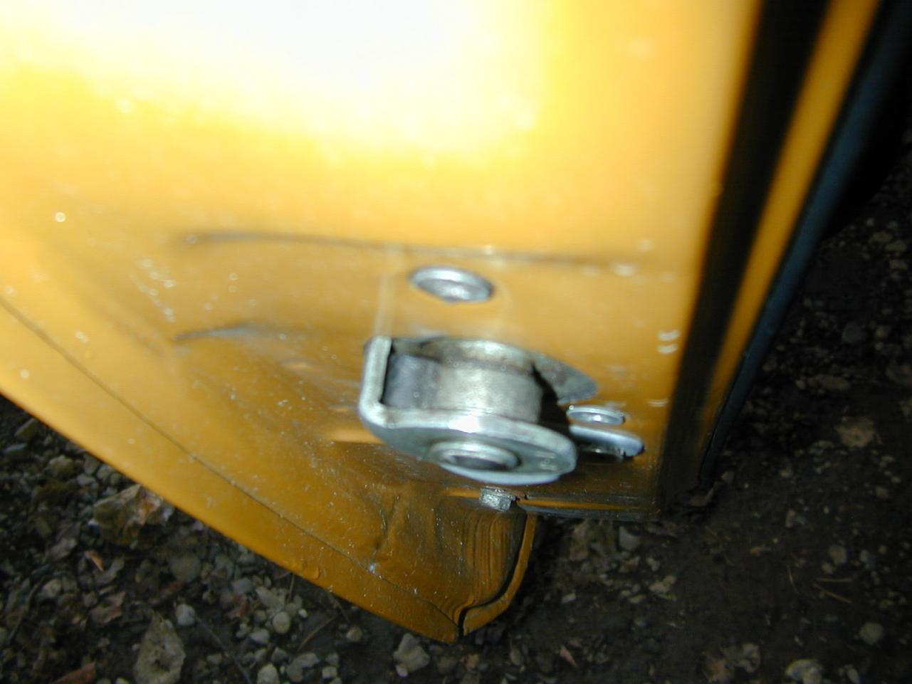

Here are a couple of pictures that hopefully will explain things.
Also, here's a quick explanation of "terms", for lack of better nomenclature.
Latch = what you can see in these pictures, the rotating part of the lock that is attached to the door.
Catch = the stamped metal piece, AKA "striker". Seen in the door striker set pic.
Lobe = the finger/arm that engages the catch.
dovetail = the piece seen below the latch.
#31 shows the rubber surrounding the lobe/arm of the latch that is the first one to contact the catch on the door jamb. They're viewed from below. This is the rubber that commonly gets lost.
#32 shows the latch once it has "clicked" twice, i.e. fully closed.
#33 shows the latch completely open.
The distance between the two "notches" on the catch (the one on the door jamb) co-incide with the rotating distance of the two finger lobes on the latch.
When you close the door, the rubber coated latch strikes first initiating the rotation of the latch and allowing the second lobe to process into the second notch on the catch.
If the rubber coating is gone from the first lobe, the distance between the lobes is now lengthened, which causes the second lobe to impact deeper into the catch than designed and as a result, will not rotate far enough to allow the latch to reach the second "click" or fully latched position.
I erred in saying that the rubber surround on the first lobe prevents rattling, but it is important to have it as it is critical to the mechanism.
Gouging out the second notch on the catch on the side closest to the passenger cabin is the "repair" that's been suggested as a fix.
The dovetail that was mentioned as missing, inserts into the spring/lever visible in the picture of the blue car. It's function is to push on the door UP and OUT as well as dampen the door "slam".
Hope this makes sense.
