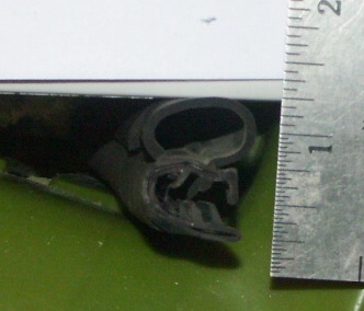

If you have 16" as left over, can't you post a pic of that, cross section view and even better if it could be compared with the original.

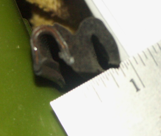

stock 240z cross section.
I did put on the kia ws on the drivers opening. I didn't cut it to fit yet, The door closes well but when opening trying to open it is a little tough. That could be because I left it long at the hinge side and might be binding.
All in all it's a very good replacement even with used weatherstripping.

Darrel. Good to hear that it's working for you! I don't think that the picture you posted is of a stock "early" Z weather strip. I believe that the early Z's used a pinch strip separate from the rubber.
