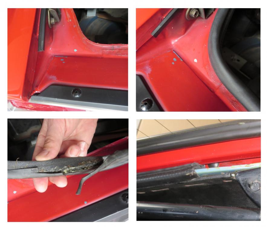

May 10, 20169 yr comment_494645 As this seems to be the thread that never dies, I guess it's a good place to ask. For those who've used the Kia weatherstripping on the hatch, how did you deal with the raised lip on the opening? It seems to be keep the weatherstripping from sitting properly, but I haven't tried persuading it with a mallet yet. Grinding the lip down or off would get the job done, but I'm hesitant to go with the irreversible option whenever possible. What did you guys do? Link to comment https://www.classiczcars.com/forums/topic/34633-kia-sportage-weatherstip-rocks/?&page=12#findComment-494645 Share on other sites More sharing options...
May 10, 20169 yr comment_494647 Im using the Kia door seal on the hatch (and doors) and I can't remember having that problem. I do remember rolling it on, sought of like it had to go around a corner because of the small lip. I also managed to get it in without cutting the seal. Btw: The Kia seals are an excellent alternative. Doors shut easy and firm, no slamming the door to get it shut. Link to comment https://www.classiczcars.com/forums/topic/34633-kia-sportage-weatherstip-rocks/?&page=12#findComment-494647 Share on other sites More sharing options...
May 10, 20169 yr comment_494674 Here are some photo's of the the lip you mentioned and the seals I used. You can also see a test piece (left over from the drivers door seal) to see how it would fit. They only cost €85 for all three and I am happy with the results. Edited May 10, 20169 yr by EuroDat added website Link to comment https://www.classiczcars.com/forums/topic/34633-kia-sportage-weatherstip-rocks/?&page=12#findComment-494674 Share on other sites More sharing options...
May 10, 20169 yr comment_494679 Some parts of mine fit a bit better than others, maybe I haven't been using enough force Link to comment https://www.classiczcars.com/forums/topic/34633-kia-sportage-weatherstip-rocks/?&page=12#findComment-494679 Share on other sites More sharing options...
May 10, 20169 yr comment_494700 18 hours ago, charliekwin said: As this seems to be the thread that never dies, I guess it's a good place to ask. For those who've used the Kia weatherstripping on the hatch, how did you deal with the raised lip on the opening? It seems to be keep the weatherstripping from sitting properly, but I haven't tried persuading it with a mallet yet. Grinding the lip down or off would get the job done, but I'm hesitant to go with the irreversible option whenever possible. What did you guys do? I didn't have any problem with the installation of the KIA seals on the doors or hatch, the hatch I just used the palm of my hand to push the seal onto that lip, no leaks. Link to comment https://www.classiczcars.com/forums/topic/34633-kia-sportage-weatherstip-rocks/?&page=12#findComment-494700 Share on other sites More sharing options...
May 11, 20169 yr comment_494741 4 hours ago, grannyknot said: I didn't have any problem with the installation of the KIA seals on the doors or hatch, the hatch I just used the palm of my hand to push the seal onto that lip, no leaks. did you buy new or used? Link to comment https://www.classiczcars.com/forums/topic/34633-kia-sportage-weatherstip-rocks/?&page=12#findComment-494741 Share on other sites More sharing options...
May 11, 20169 yr comment_494798 Used, $10 bucks at the wreckers. Link to comment https://www.classiczcars.com/forums/topic/34633-kia-sportage-weatherstip-rocks/?&page=12#findComment-494798 Share on other sites More sharing options...

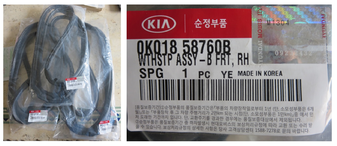

October 1, 20204 yr comment_606953 Hi guys... what do you think of the dimensions of this profile.. is that similar to the Kia one ? my seals were toast when I got the car so dont have anything to compare to Link to comment https://www.classiczcars.com/forums/topic/34633-kia-sportage-weatherstip-rocks/?&page=12#findComment-606953 Share on other sites More sharing options...

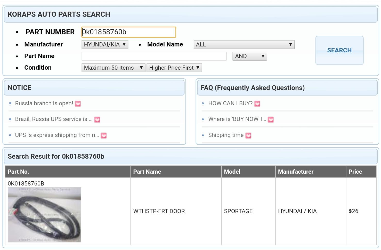

October 1, 20204 yr comment_606961 Why don't you go to www.koraps.com and buy two new ones. 0k01858760b right 0k01859760b left Left and right. I could tell the difference. The most people that have used them find they fir very well as an alternative to finding originals this in usable condition. I have to admit they are darn expensive at $26 each an $6 shipping. They were $12.50 each when I bought mine. Link to comment https://www.classiczcars.com/forums/topic/34633-kia-sportage-weatherstip-rocks/?&page=12#findComment-606961 Share on other sites More sharing options...
November 17, 20204 yr comment_610567 Ordered a set on ebay, 104 shipped for both sides. Not cheap by any means, but if it means my doors close with ease, worth it. Koraps is still 26 per side, but they wanted almost 60 dollars for shipping 😨 Link to comment https://www.classiczcars.com/forums/topic/34633-kia-sportage-weatherstip-rocks/?&page=12#findComment-610567 Share on other sites More sharing options...
