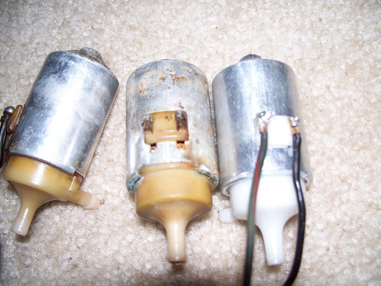

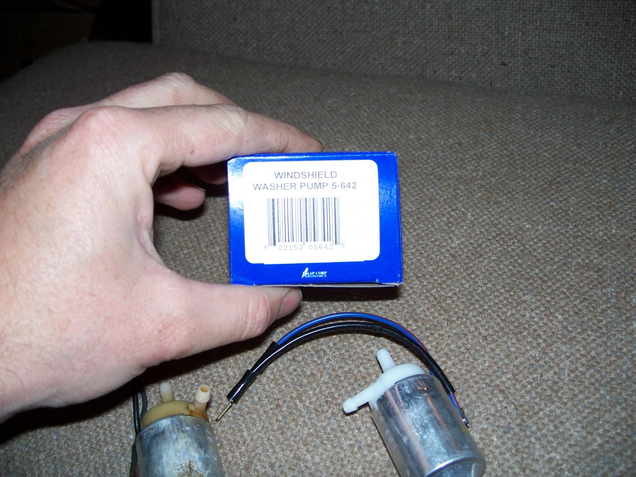

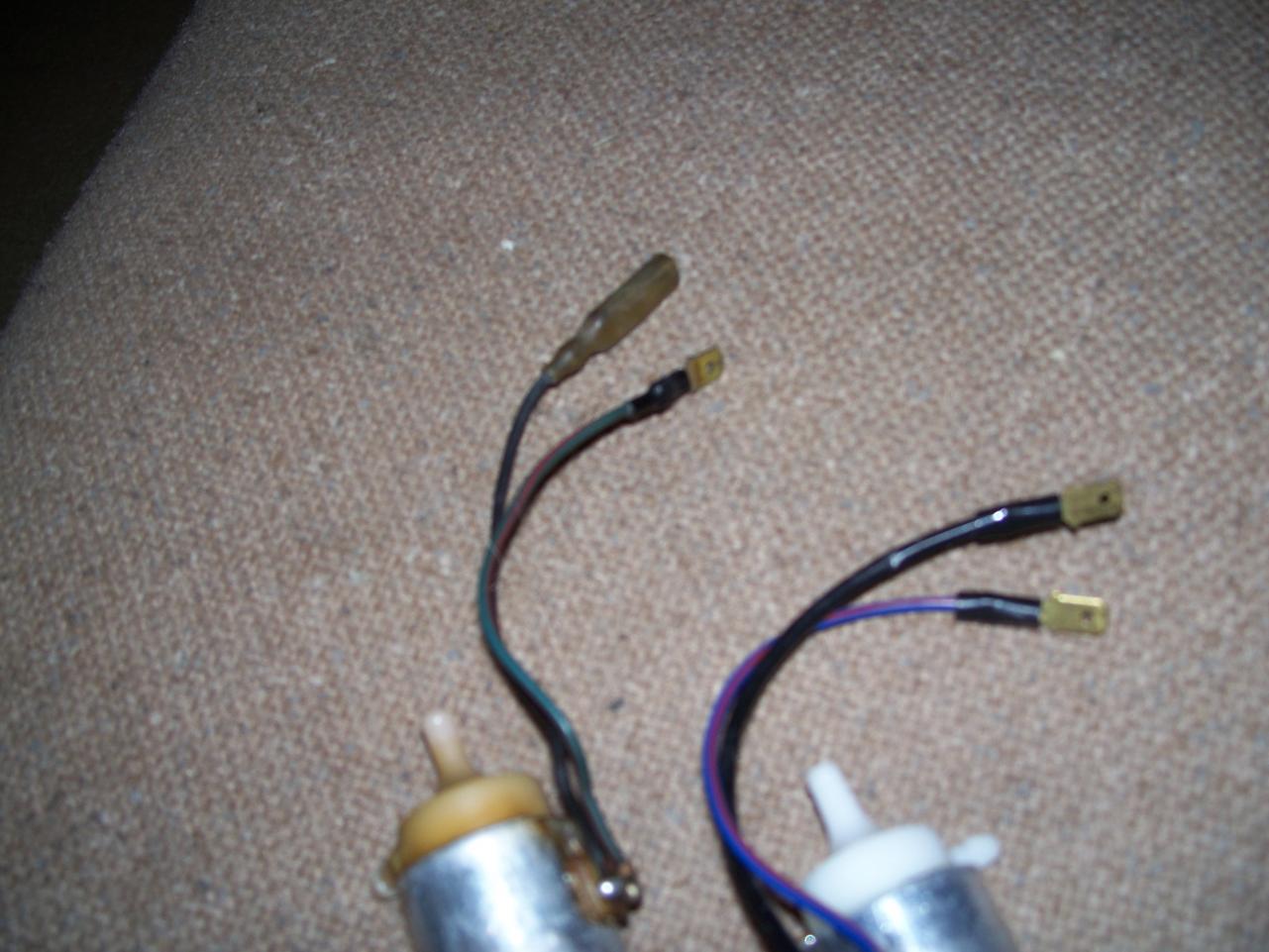

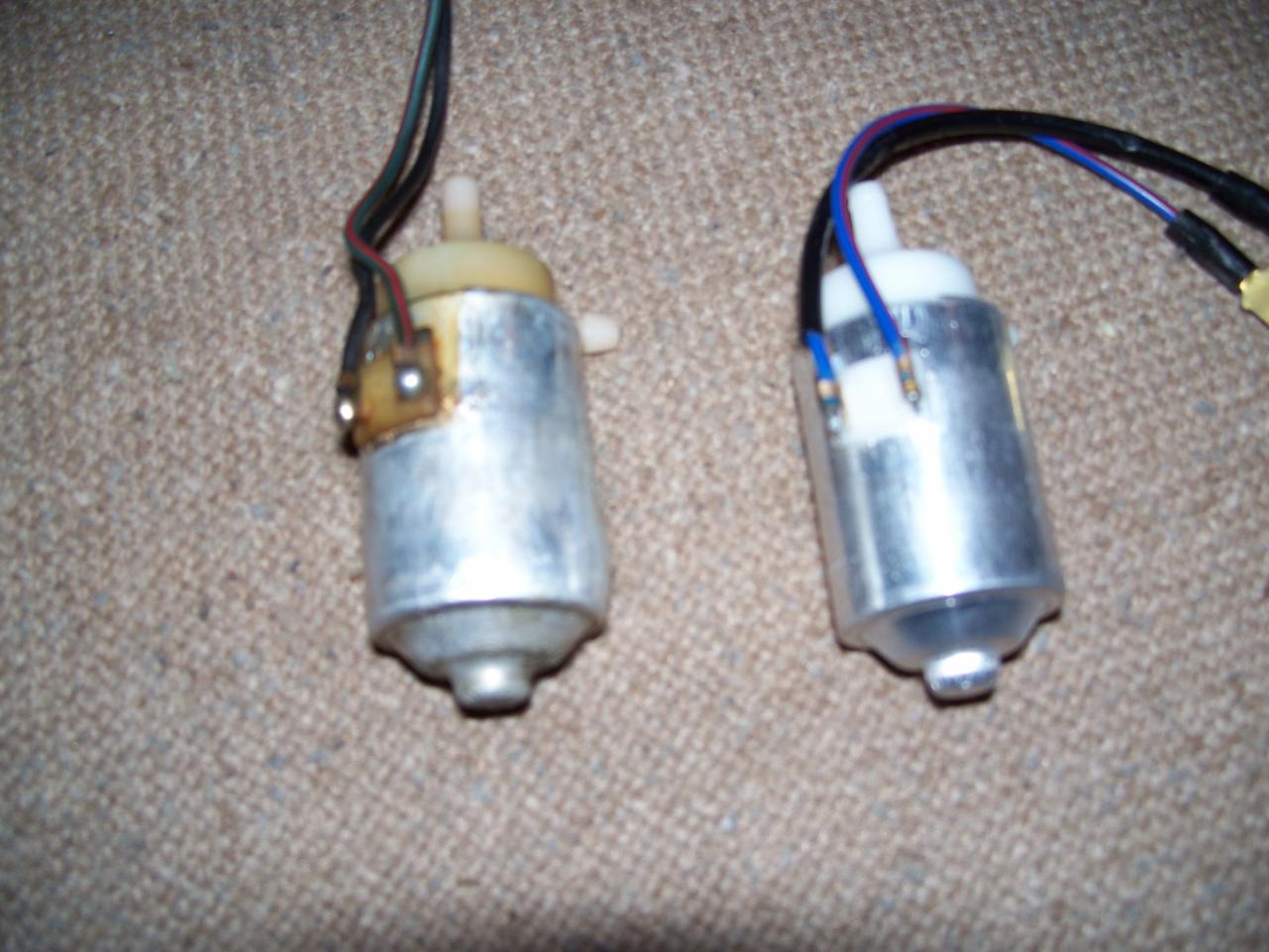

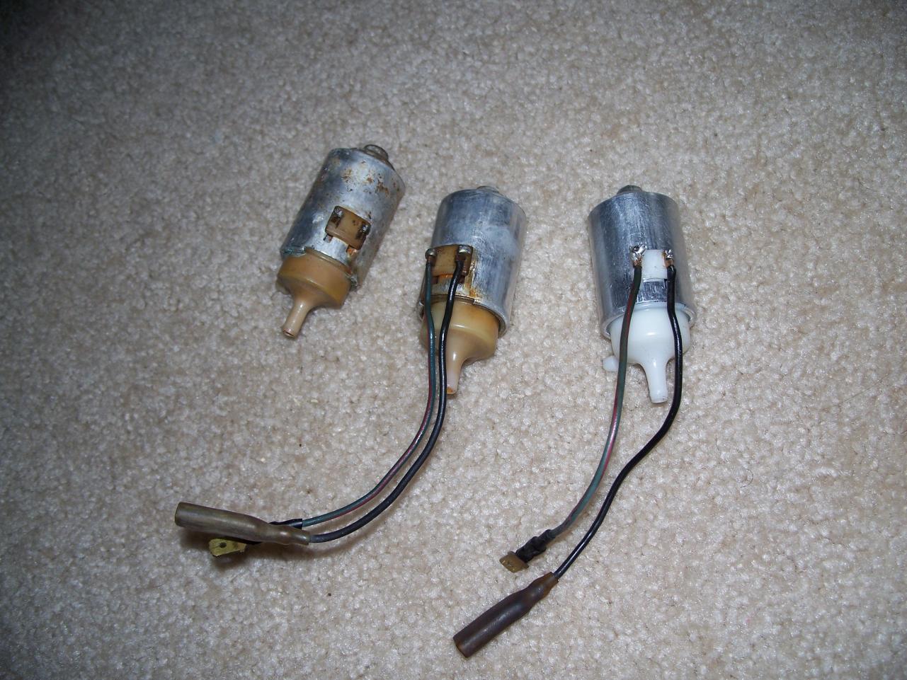

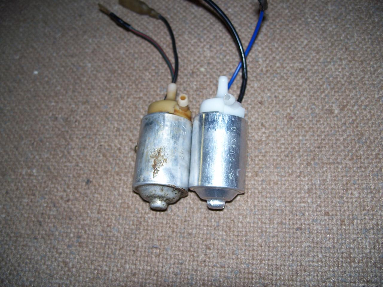

Hey thanks for the tip it worked out great I went to Auto Zone with that number, well they don't sell Trico, but they typed the number in and found the match from TAAP CORP (their part number 5-642), USA made for $14 and change. The only difference I can see the the wires which is easy to fix and the numbers stamped in the side are different. Here are some pictures also the old pump is always on the left.

OK I made the mod the longest part was waiting for the iron to heat up. I pried the tabs up, melted the solder. On the old pump and the new one. Then I bent the tabs back with the old wires on the new pump and welded it together. Once the soldering iron was warm it took about 3 minutes to do. :classic:
