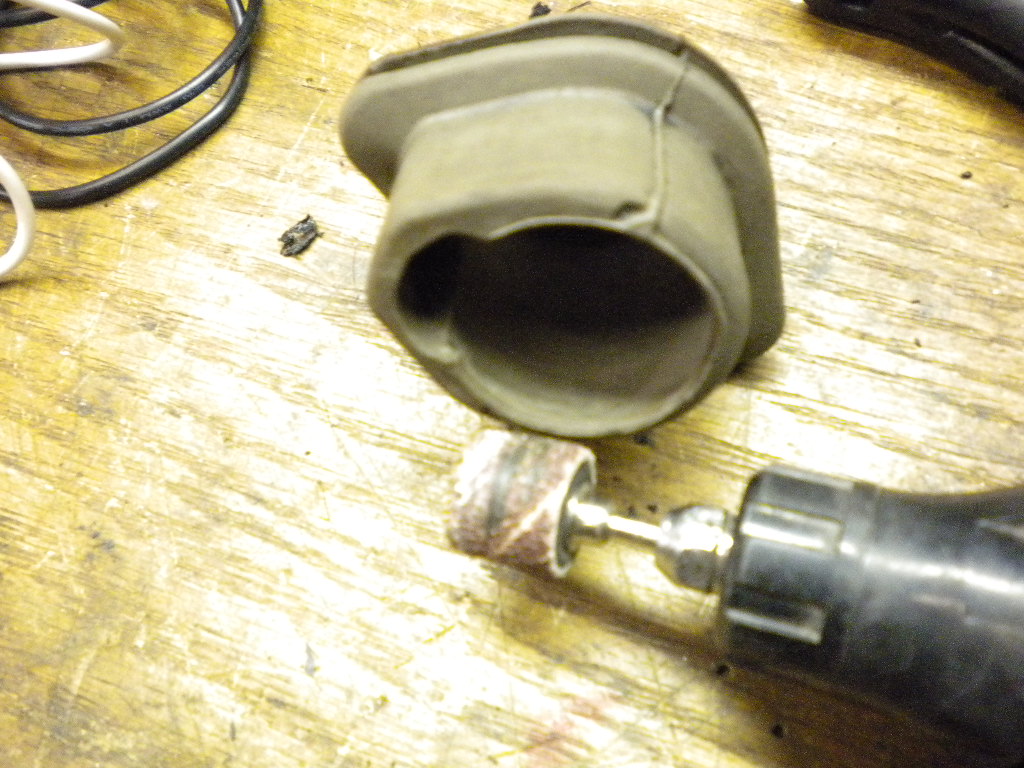

Remove your old motor by disconnecting it and sliding it out of it's rubber boot. Now take a small drum sander on your dremmel and Hone out the inside of the rubber boot, making sure to remove the motor retaining lips from both sides of the lip. Hone it out till the new motor will fit in there snug.
