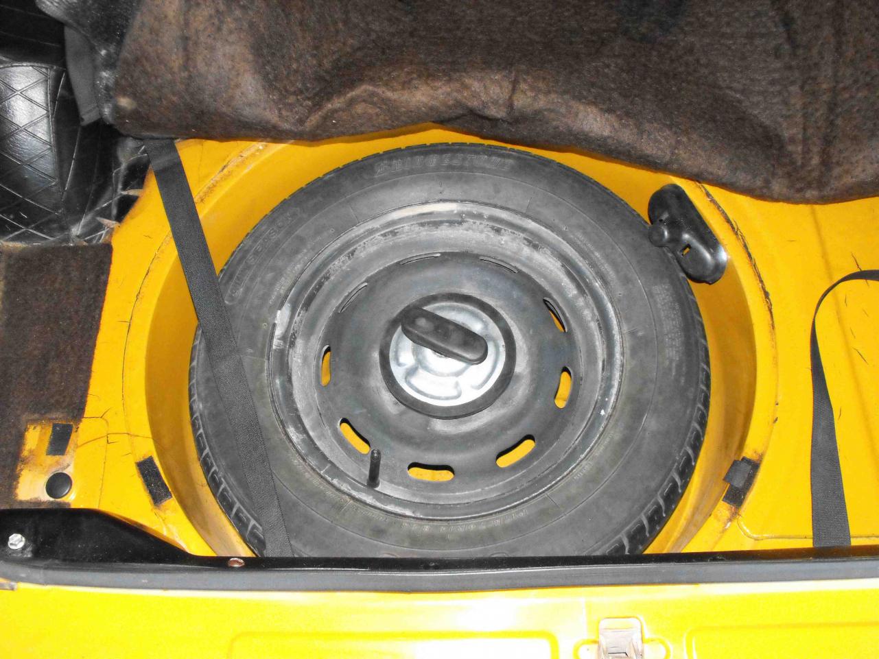

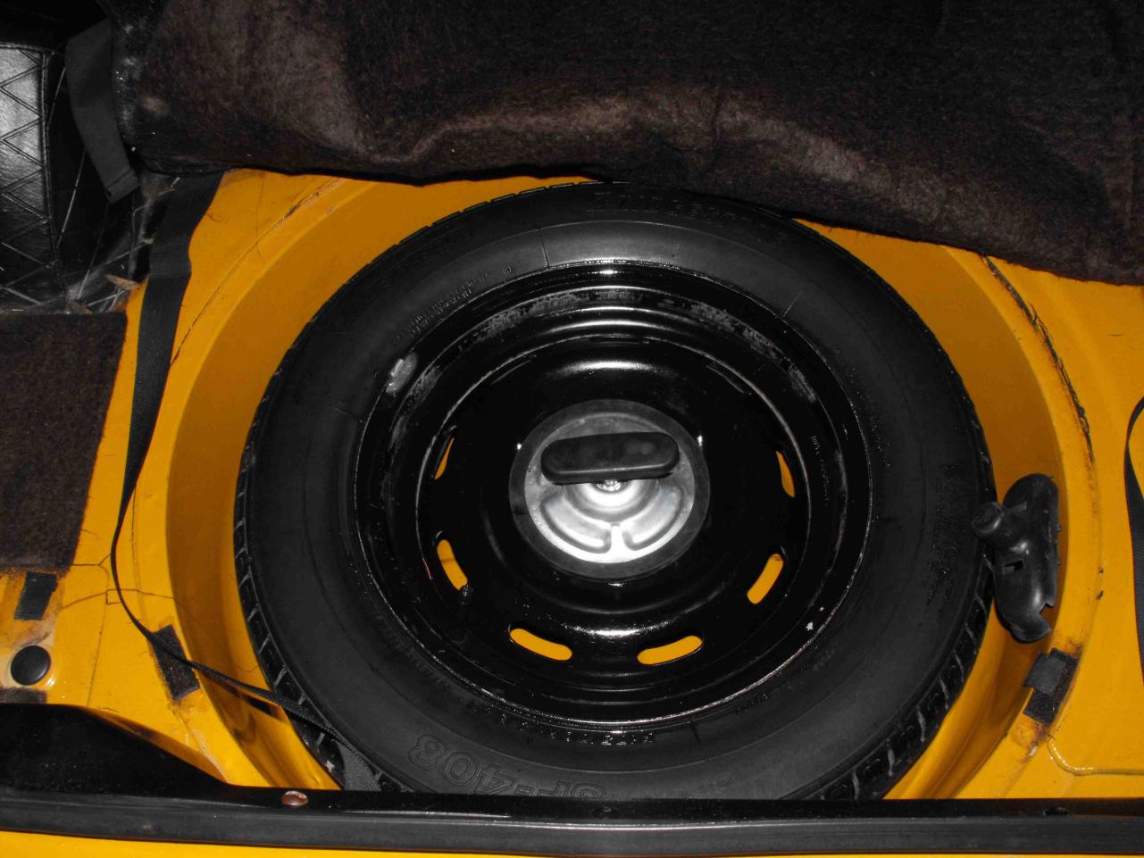

Nice Bridgestone, but I have a general comment about securing the spare tire in the tub.
Is it just me. It seems that, more often than not, when someone posts a picture of the spare tire, the hold down bracket appears to be installed upside down with the rubber protected edge of the hold down facing upward, instead of down and against the steel wheel for protection.
Interested in opinions if I have this all wrong.
Dan

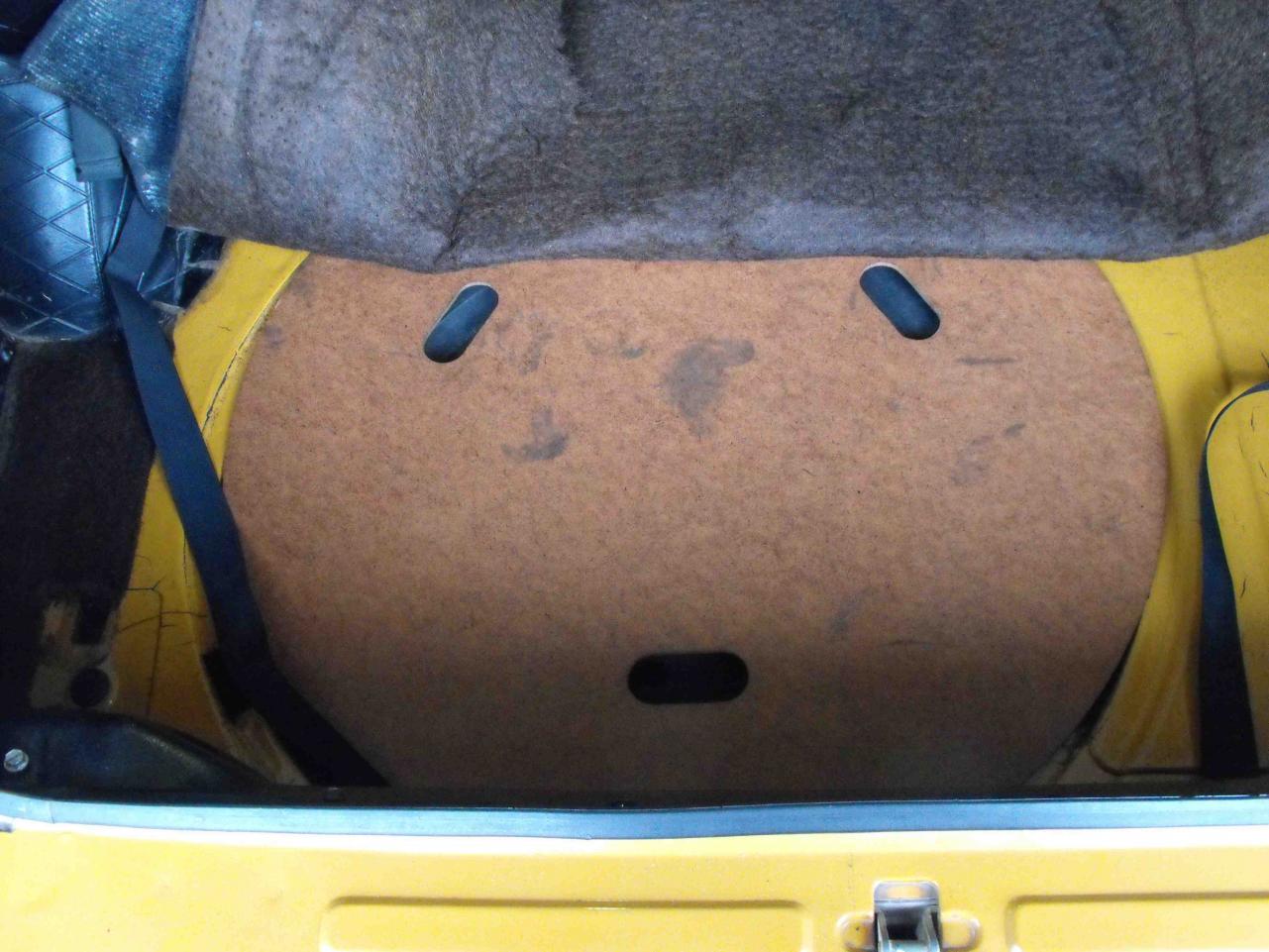

You've sparked my curiosity now. I am betting the spare tire compartment of my 70Z has never been touched or opened. I'll check it tonite and post pictures.

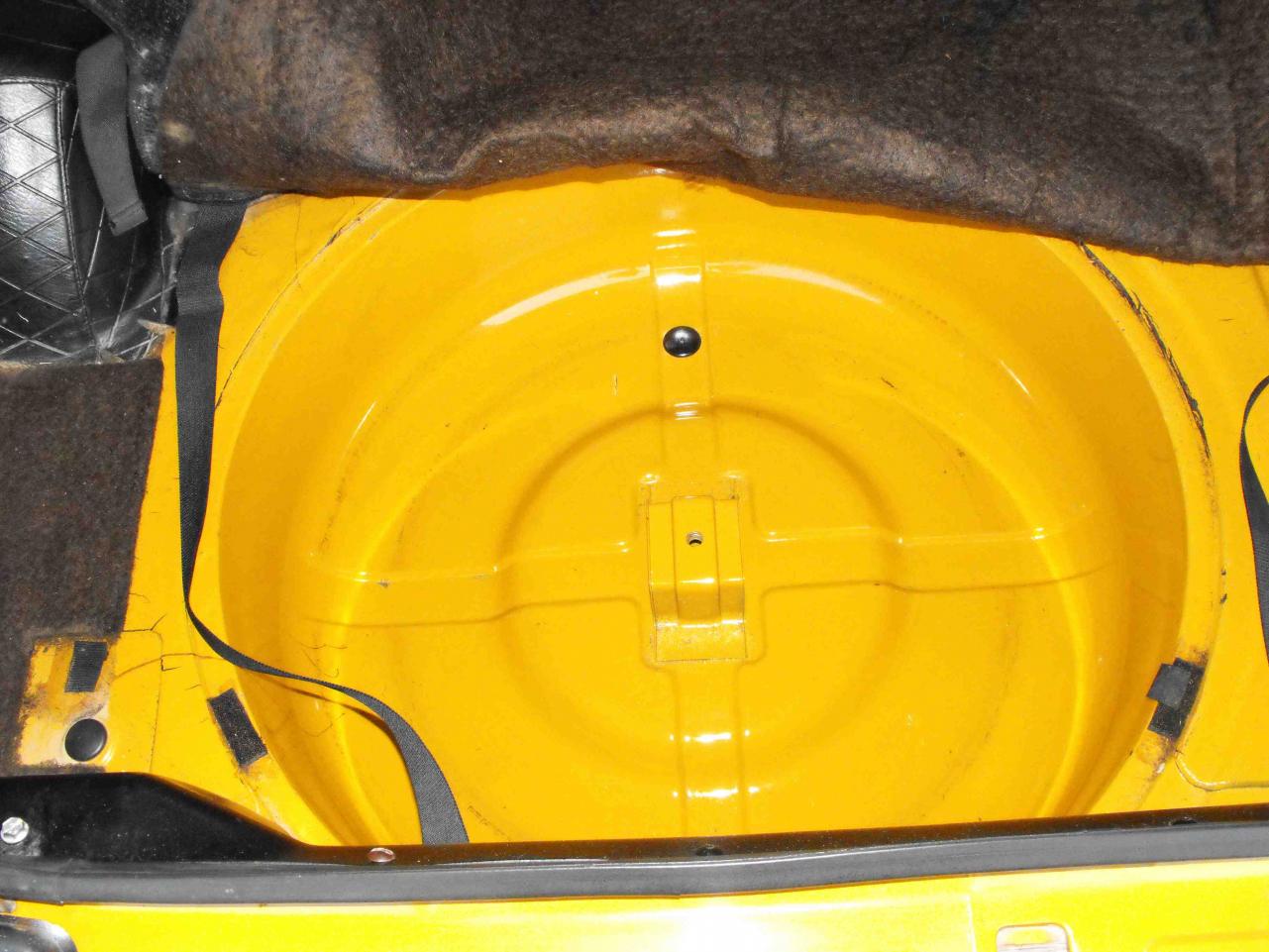

Boy, I was a bit overly optimistic. Looks like Dad was in here way before me.
I thought the cover looked pretty funny, almost like a smiley face, but not smiling. I think that was on 180 degrees out as there was an arrow on it pointing aft and the flat on the forward end. Fits better with the flat towards the back and I am guessing the arrow should point forward (unless you drive in reverse most of the time).

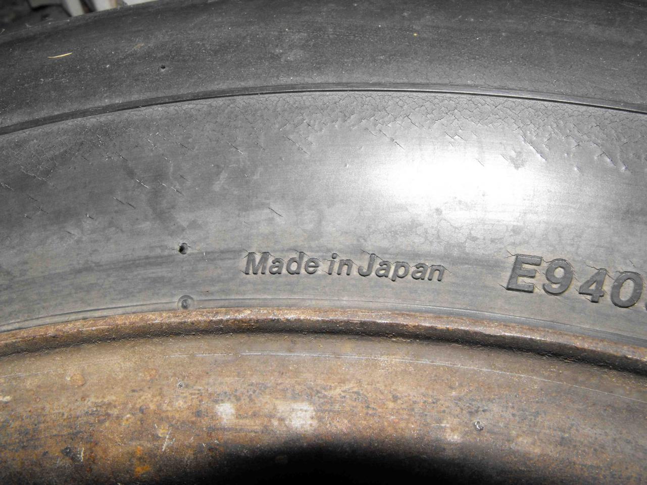

I found an old Bridgestone tire in there. Looks like it may be one of the original 175/70/14s as it was a bit worn. I like the made in Japan emblem there. You can see the Hubcap scrapes on the rim and the location of the old tire weights.
Lots of padding hair in the bottom so I cleaned that out. The paint looks real nice as well. There was a bit of stray glue in the area but no rust. I cleaned up the tire a bit and re-assembled everything. That was fun.
Anyone know what that black plastic thing is?
Rich

Bad news, Rich. That is not the original tire. The originals on the early cars were Bridgestones, but they were 175SR14, not 175/70-14s. That is a much later size, and the SF-408 model (Super-Filler) confirms that. The early cars came with "Super Speed Radial 20".
I borrowed these pictures from an earlier thread.
AAhh, that's right. The 70 series should have clued me in. The glove compartment decal specifies the 175SR14. I'm thinking the 'S' is a 78 series tire.
I did notice the rim had the black front and the silver back. Now I am wondering which tire on the car has the original spare rim. Then again, I am sure there are much important things to consider.
Thanks for the input.
Rich
The 'S' is a speed rating, 113 MPH in this case. (The 'H' for the later tires is 130 MPH. The 'R' simply means Radial.) When the aspect ratio (the '70' in 175/70-14) isn't specified, 80% is implied. So a 175SR14 tire is equivalent to a 175/80-14.
