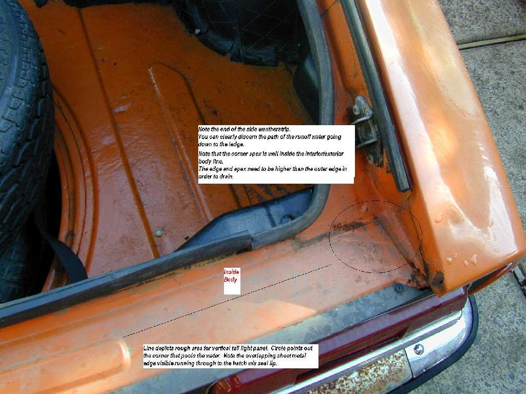

I've got an issue with rain water pooling on the corners of the rear hatch ledge. The water gets deep enough to seep into the drain holes on the bottom of the hatch itself. From what I can tell, the water runs down the outer hatch weather stripping, and then drops into those corners. I figure it can't be good to have water sitting on the hatch ledge and seeping into the hatch. I don't have any rust issues there, and I'd like to keep it that way.
Anyone else had and solved this problem?

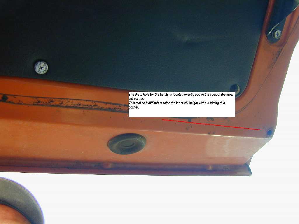

You might be able to weld something, just like if you were to add some fiberglass, epoxy or some other material but the biggest problem is the shape of the hatch itself doesn't allow for much build up in those corners before it interferes with the hatch.
Drilling holes would only vent the water INTO the cabin right about where the tail-light metal, fender and inner support metal comes together. Even if you were to successfully locate, align and drill the hole such that it actually did vent to the outside, the possibility of the water then creeping in between one or more of the metal pieces there would quickly cause more problems than it's worth.
Sounds absurdly simple and in need of a simple fix, but it's one of those problems that quickly morphs into a HUGE problem.

The length of the weatherstripping is such that it still pours into that area.
Look at the two attached pictures to get an idea.
E

Sounds like we all have this problem with our S30s, and nobody has solved it. You can't extend the weather stripping, because there's nothing to attach it to. I can't not drive the car in the rain, because I live where it rains frequently and unpredictably. I can't even park it facing uphill, because we have zero hills. Our island ranges in height from sea level to 16ft. Not much slope. Maybe I'll get bigger tires/wheels for the front. ROFL
I've thought about building up the corners of the hatch ledge, but not sure if you can do that enough without interfering with the hatch closing. It'd also look like a sloppy attempt to patch rust. I currently don't have rust there, as I've already fixed the little bit of surface rust that was forming, so I'd like it to look original and correct. I may try the idea of putting a lot of wax in those corners. If that works, maybe there's some clear sealer that can be put on there for a more permanent fix. That still wouldn't keep the water out of the hatch itself, but I think I can stop that by plugging up the two small drain holes on the inside lip of the bottom of the hatch. Mine currently have no rubber plugs. I have plugs on the two larger holes, but not those tiny holes. Were they supposed to be plugged?
