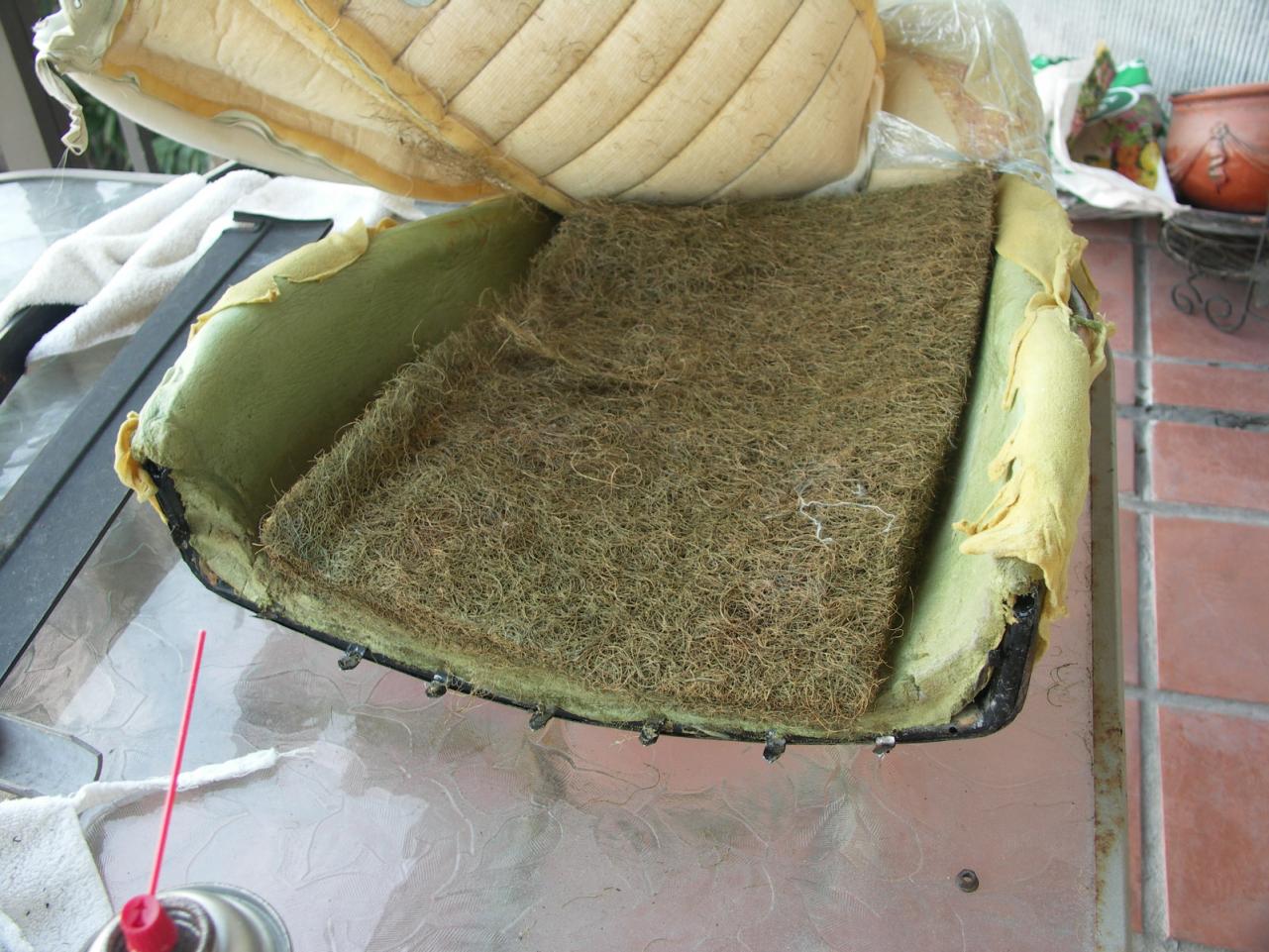

They have springs. It could be that the old cushion is shot. Attached is a pic of what came out of mine. From the box of receipts that the PO kept, the seats were recovered in 1985. I suspect the old cushion was reused, but they added the extra padding on top of it. That grass stuff sure did stink. Gone now...replaced with new foam.
If the grass stuff stinks, don't smoke it.ROFL
It can be the cushion's and i'm planning on getting some new from Les at CDM, but this feels more like i'm sinking down because of weak springs.
