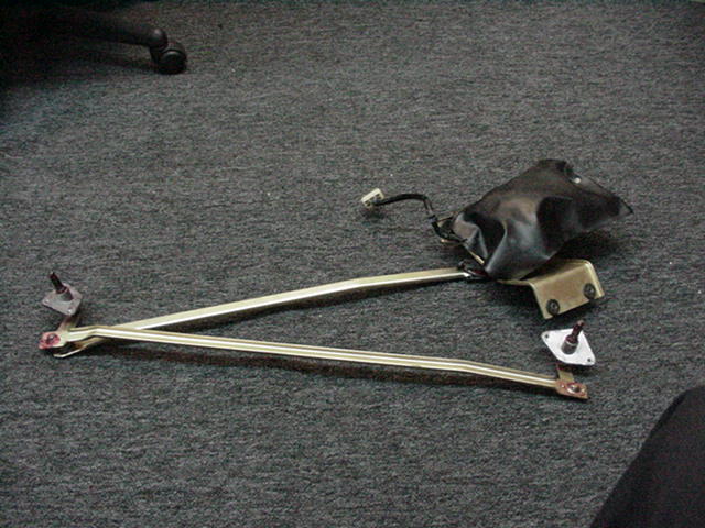

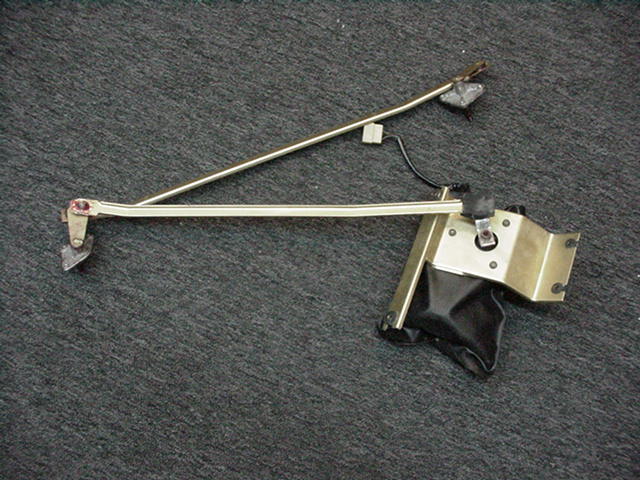

First of all, many people try to put new/different motor.....,but the question is....Does that really solve its fundamental problems?
I would like to share "Do it yourself" tip here.......
1. You remove the cowl, wiper motor & regulator assembly.
(do not break all the snap rings and clips)
2. Take apart all joints of the regulator & clean with carb cleraner, then grease them up with high speed grease that you use for your wheel bearings.
3. Take apart motor and clean up brashes , gears, and all the contacts inside the relay(you have problem with this replay, and this is what brings wipers back to original position when it is turned off)
4. Paint or plate all the arms after removing rust off with steel wool.
After this whole process, you can feel a significant different in smoothness of the wiper movement. Less resistance=less current draw from the motor.
This costs under $10 including paint and grease. I hope this would answer your questions.

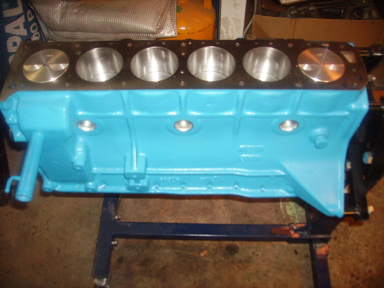

It all depends, Duplicolor is like 25 bucks a can, but the other day i found a sale with satin black among other colors, the price was 6 bucks for two rattle cans and satin black is not everyone have around here.
Among the other colors was the one i have used on my block, i think it is pretty close to the original, it works for me.

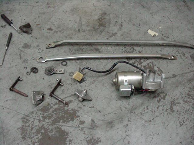

Today I finally had the time to pull my wiper motor apart – I cleaned it up and fixed a loose connection in the parking locating switch, located on top of the motor/gear with a yellow and a Blue/red wire exiting from it. The problem is now that the wipers are continuously with the stick switch at the steering wheel in the off position (motor running “backwards” compared to normal operation) I figured out, that the motor running “backwards” is probably correct and then it ought to stop when it meets a certain position and the switch is activated – but it never happens, and I suspect that the switch is activated at all times, and there is a problem with the wiring or relays.
The wipers still only complete half a sweep in the intermediate position – then the relay inside the car switches off
Otherwise seems the wiper action a little stronger after the cleaning and re-greaseing of the motor.
