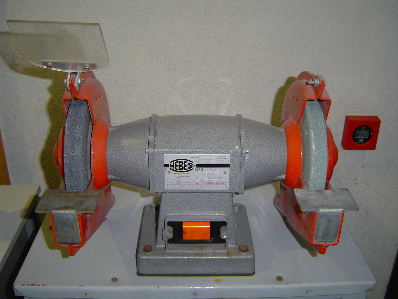

I took one piece of the holder strut off and "cut off" a little of plastic with a machine, (see picture, sorry my english). The finish was very good, much better them a X-acto, that i tried as well.
Besides, with that machine it cleans and soft were i cuted before, so it was a better finish.
What i also did was, the straith parts ends, i round them a little with the machine and once again it was great, no one see the differences.
