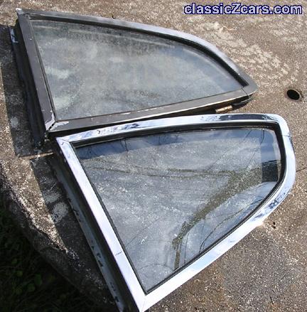

For hard water spots, sometimes placing and holding a paper towel soaked in white Vinegar on the area will take care of the deposits(essentially the same thing as Boiler scale). I have always used the Eastwood glass polishing kit. It can handle both situations.
Here is a before and after...
Edited by hls30.com

Are you sure it's on the outside of the glass? I have three windows on my 240 that are going bad inside. They have a white haze or fog with it aswell. What is happening is safty glass is 2 sheets of glass with a clear rubber between the two parts. Over time with sun and heat that rubber can go bad. When that happens you can get a milky look and little bubbles over time.
If thats the case your only fix is new glass.
