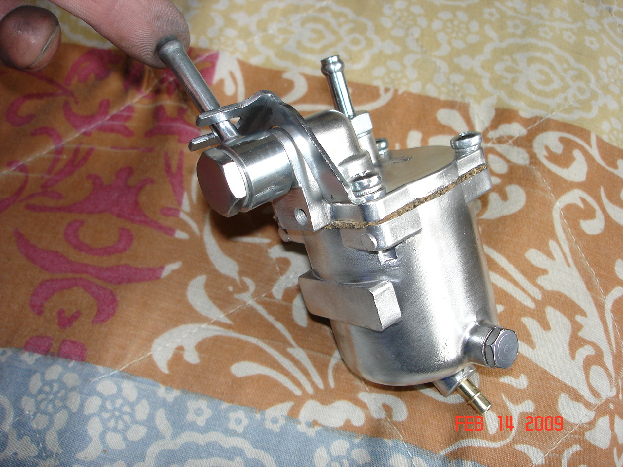

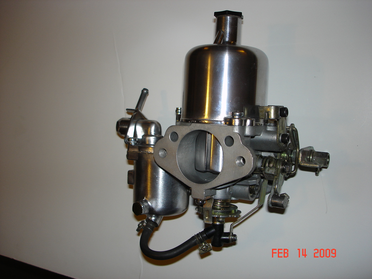

Here's the Carbs I'm working on this week.
Before and after. From Yuck to Yeah!!! Thanks bruce, did you get my email?

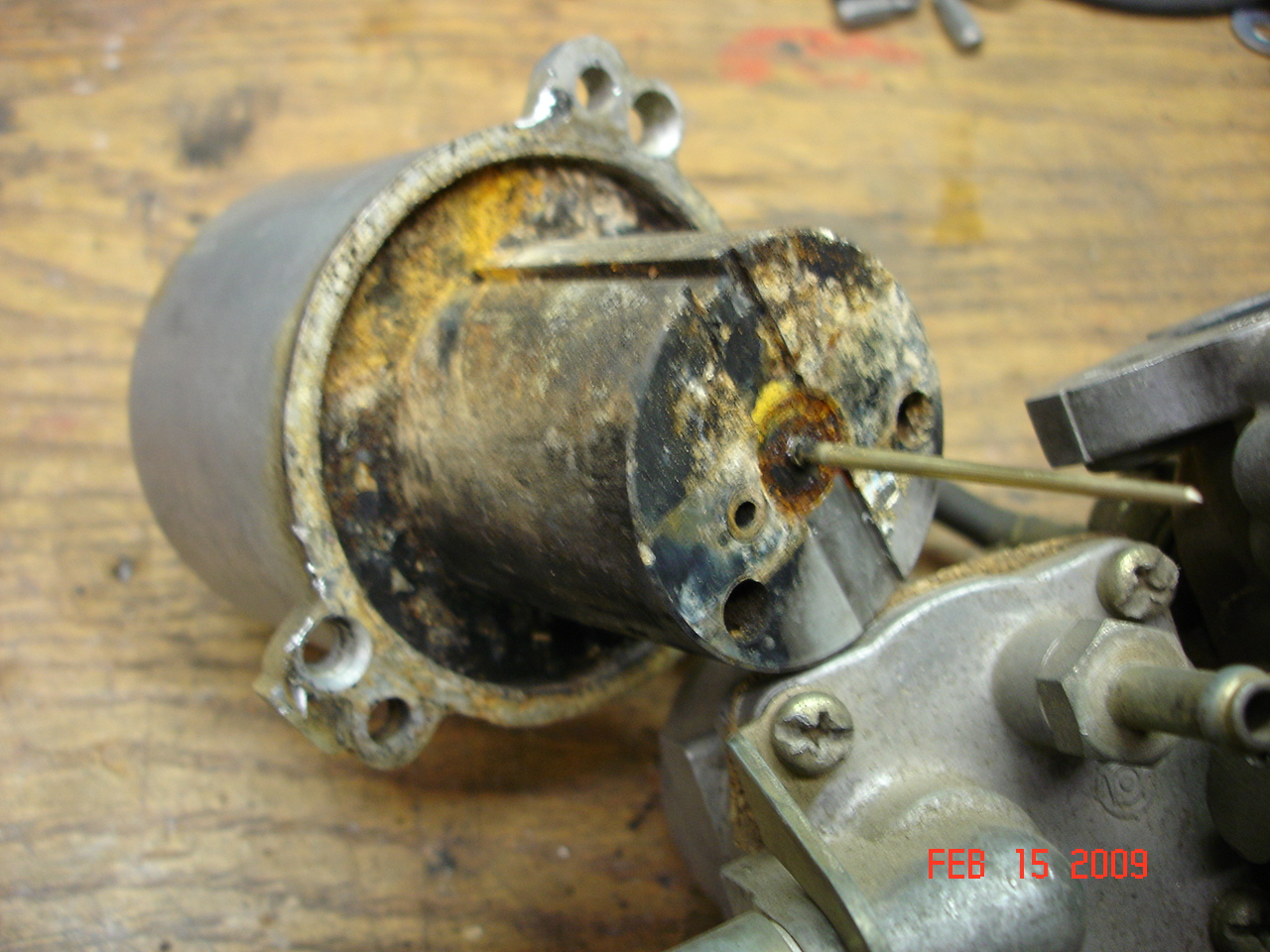

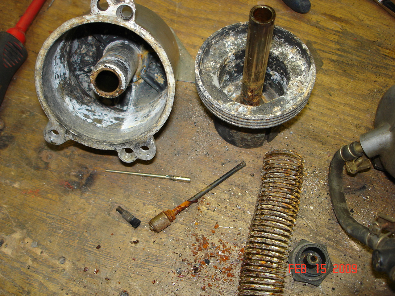

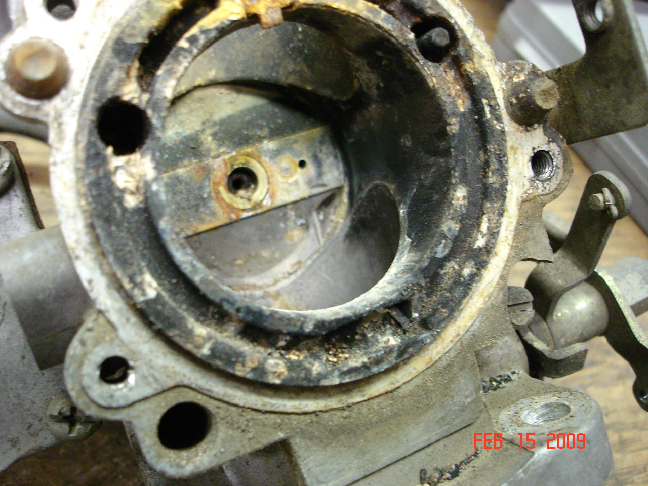

The pistons were stuck in the domes, the float bowls were full of white corrosion, Nothing moved before I got to it.

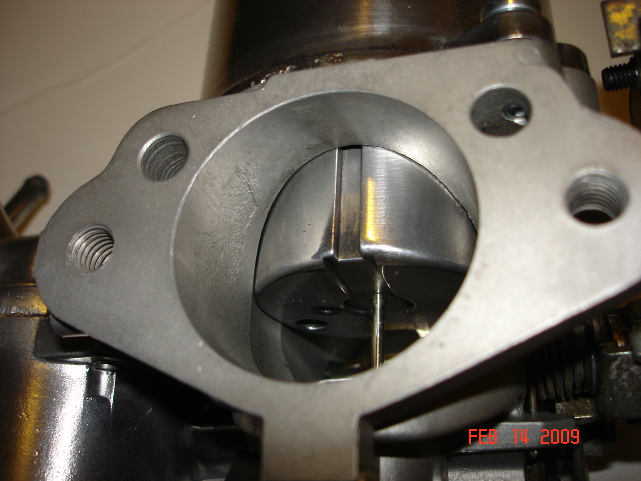

As you can tell from the pictures, the domes were in pretty bad shape. Just pay attension to the STEEL items like the steel shaft in the piston. The picture below is of the piston that came out of that one. It was pitted too badly to reuse, so it will now be used an an alignment tool for the 4-screw carbs I have.

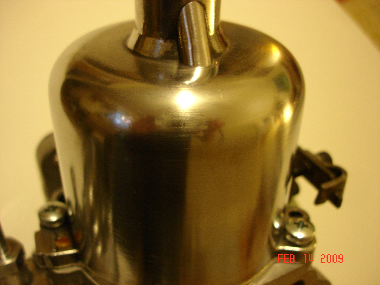

To bring the luster back, I found a long bolt (4.25" long) and 2 washers that were only slightly bigger in diameter, than the openings on the dome. (top one at 3/4" OD and the inner bottom one at 1/2" OD) both with a 5/16" bolt hole. Then give them both a 45 degree angle on the outer lip. This will seat them and center the bolt.
I put a nut on there and snugged it down. I use a small benchtop drill press. Once it's in and can spin without distortion, or wobbling, I use the red Scotchbrite on a medium speed. DON'T HIT YOUR FINGERS on the spinning bolt flange near the bottom of the dome.
I knock all the crap off with the scotchbrite pad and if it needs more surfacing, to remove fine cracks and such, I use 400 grit wetsanding paper, as it's a better quality than typical sandpaper. After the 400 grit, use the scotchbrite to clean a little more than I use Mothers Aluminum Wheel Polish on a soft cotton towel.
For the upper vent tube area, I use a buffing pad to get the hard to reach areas and also down by the feet, where the drill press method does not work. Takes a little time and effort but as you can see, it's well worth it. I top it off with Miguires Cleaner wax to keep it shiney.
The same process is similar for the piston but Do Not use anything stronger than the scotchbrite. If you take away too much surface from the rings on the upper part, the piston will not work correctly and be worthless. You can also use the scotchbrite on the inside of the dome. I obviously had to do that on mine. Clean everything with brakeclean and you can wipe the inside out with ATF fluid on a clean soft cloth.
