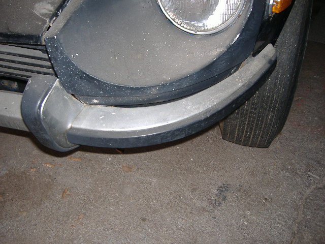

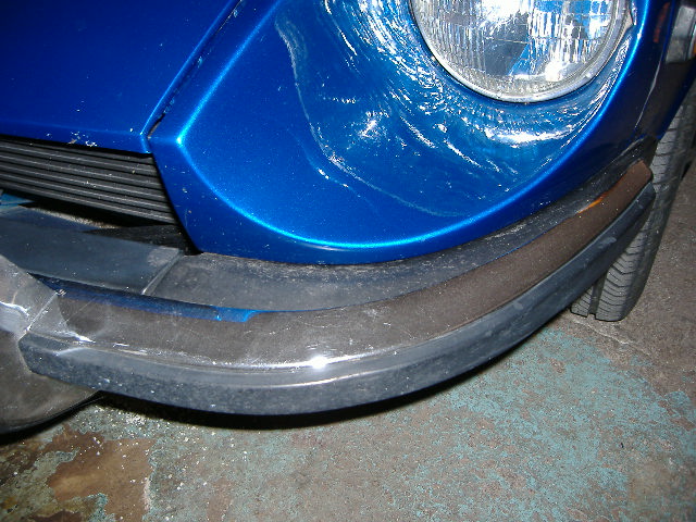

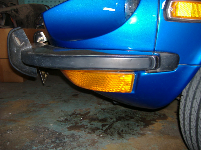

February 12, 200916 yr comment_273911 "Also note that the '73 240Z and the 260Z have different bumper bracket mounts than the '72 and earlier bumpers, as well as a slightly different curved shape to work with the rubber packing pieces that go between the bumper and the fenders on each side. "Anyone have good side by side pictures of the differences?My parts car has a front bumper that was rechromed and looks great except that it was bumped and sprung so it looks like the one in the first picture. Link to comment https://www.classiczcars.com/forums/topic/30665-new-front-1971-240-z-bumper/?&page=3#findComment-273911 Share on other sites More sharing options...

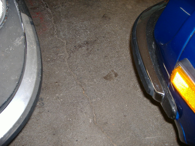

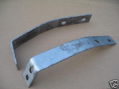

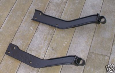

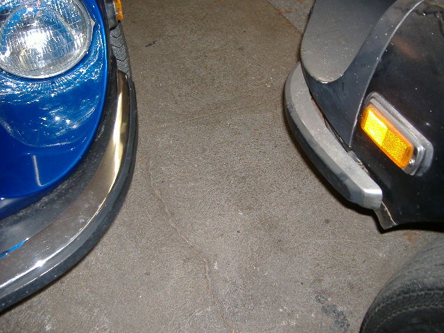

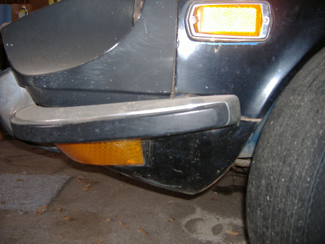

February 12, 200916 yr comment_273946 Here you go (steel colored ones are 70-72, black ones are 73): Link to comment https://www.classiczcars.com/forums/topic/30665-new-front-1971-240-z-bumper/?&page=3#findComment-273946 Share on other sites More sharing options...

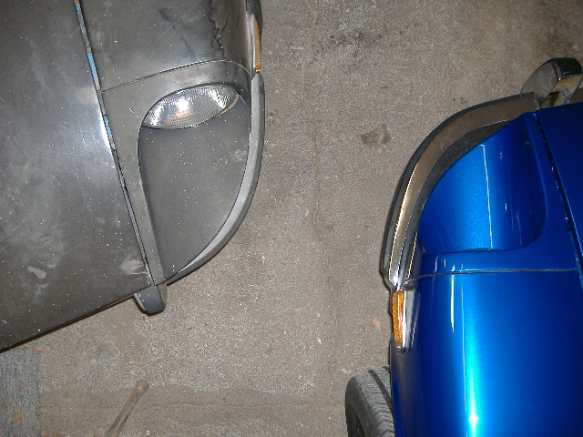

February 12, 200916 yr comment_273950 Heres what they look like side by side on the car. The blue one is a 7/73 and the black one is a 12/69 (#110). Bonzi Lon Link to comment https://www.classiczcars.com/forums/topic/30665-new-front-1971-240-z-bumper/?&page=3#findComment-273950 Share on other sites More sharing options...
February 12, 200916 yr comment_273962 thanks! That finally cleared it up for me. Link to comment https://www.classiczcars.com/forums/topic/30665-new-front-1971-240-z-bumper/?&page=3#findComment-273962 Share on other sites More sharing options...
