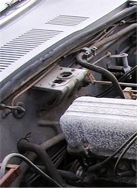

Hi All. I have a grommet that is disintegrating on the firewall. I have attached a picture of someone else's firewall. The grommet in question is directly to the left of the hood catch.. The grommet is about 3 inches above the water inlet (or outlet) hose. What is this for? Is it for the windshield wipers?
The wires coming out are enclosed in a black plastic tube that has a semi large connector on it. If I find a replacement grommet, how do I get the wires through? Do I remove the cowl? Can the wires hidden under the cowl be threaded through this grommet somehow? Do I have to cut the wires and then splice them back together? Seems like Banzai has a reproduction if this is indeed the item. However I looked on their website and it doesn't seem to be quite the same.

Yes, that grommet is on the wiring for the windshield wiper motor. I think Banzai is the only place I have seen with a reproductiion. I haven't compared them to see how similar they are. I would guess that you would need to slit the grommet to get it over the wiring.
To remove the cowl or you remove the six or so small screws at the front edge of the cowl (maybe the two hood bumpers too) and slide the cowl forward. There are several tabs on the back of the cowl that secure it.

I purchased this grommet from Banzai and it is quite nice and accurate, but anything you get from Mike is going to be extremely accurate and of high quality from my experience.
To install, I removed the five or so wires and conncector pins from the windshield wiper harness plug which lays against the fire wall, (you need to number the pins and the slots on the plug to reinstall correctly) pass the harness wires through the grommet, and reinstall the pins in there respective plug holes. I hope this makes sense. If you have never removed the wire pins from a multiple wire connector plug, it is important to know how this works. Each copper or brass pin on the ends of each wire has a little tab that hooks onto the interior of the plastic connector and this tab must be depressed with a very small tool to allow the wire and pin to be removed.
When reinstalling the wires, just pry up this tab again so it is secure when pushed back into the plastic multi-wire connector.
If you can do this, there is no need to split the grommet or remove the cowl to install this grommet over the harness wire.
Let me know if more explanation is needed, and best of luck.
Dan
