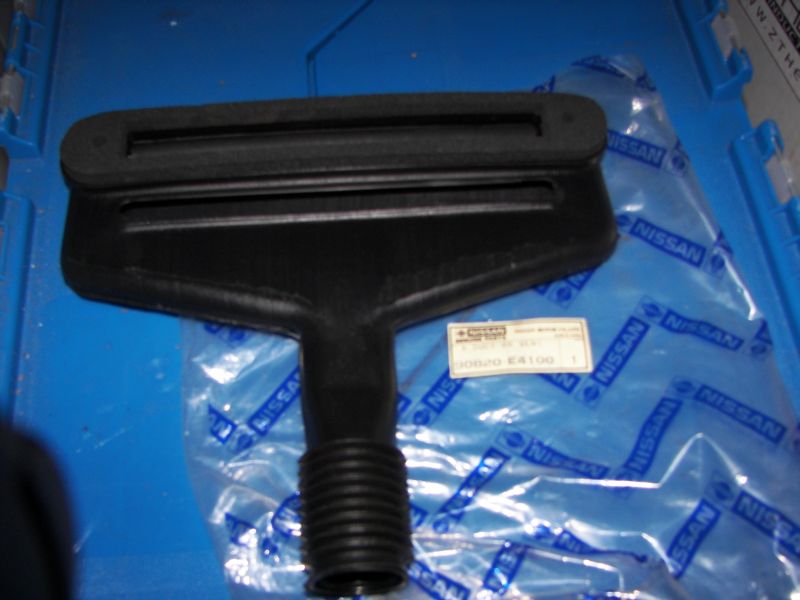

Oh sure! Now that I braved the freezing monsoon....Ok, a lite drizzle and 40 degrees....
Anyway. Internal part 90820-e4100
Will, how would you go about sealing the openings for the hatch vents? I have a decent quality vent (part #90820-e4100) but always concerned about exhaust concerns.
Another question: how would you insulate around the hatch latch so exhaust wouldn't get in?
I am analyzing all exhaust leak options and any answers regarding the hatch would be appreciated!

For the vents, I am using a gasket I made from adhesive backed neoprene foam to seal the vent plenum to the inside of the hatch.
I am using pretty much the same thing on the lock mechanism-a sheet of the same neoprene sealing behind the mechanism.
