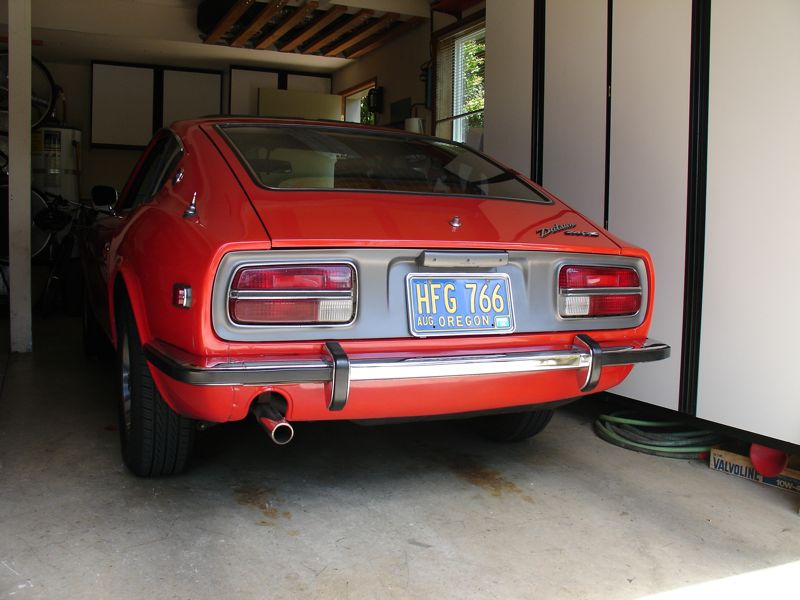

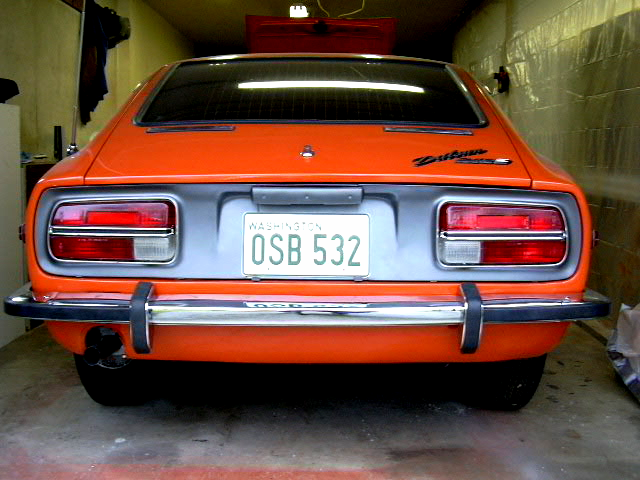

This is as close as I could get the hatch. Ended up making tapered shims for the hinges. They were tapered in two directions and after it was all done I can not tell you what I ended up with installed.
