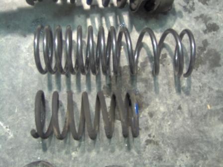

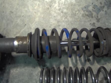

Here is a picture of the coil over. I have also a picture with the coil over spring compare to Eibach Prokit spring.
For your information, Front Spring/R is 218 Lbs/In and rear Spring/R is 271 Lbs/In on the cowl over set up.
I've measure the cowl over spring and they measure 9.5 inch. The strut seam to be the same lenght than standard one.
So know my questions are: Can I ride with the standart Tokico HP shock with the coil over spring set up? Would this ridable on the street (This is a week end car)?
Thanks in advance for your input.
Joce
Yes, depending on the internal length of the strut tubes. I can also set you up with shorter HP shocks that will fit fine inside shortened strut housings, if yours are shorter then stock. But, with the spring rates you list, you'll be about at the limit of the rebound control offered by the HP shocks. The Illuminas would be a better choice and the Tokico HTS shocks the best.
