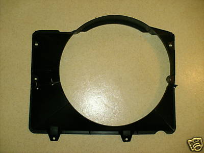

The 280Z uses a slightly different one....similar, but not interchangeable-here is a NOS one for a 280Z...

Thanks, that makes sense and also thanks for the link. I'll watch the auction and see what happens, might consider it.

I want one of the hinged radiator shrouds too! They're the easiest to install.
By hinged radiator shrouds do you mean the two piece shrouds shown on the site that Kats posted the link to? I thought those were only for the 280z and the 240z used the single piece metal ones. The site shows the two piece shroud for the S31 and the single piece one for the S30.
-Mike
I'm really not sure Mike. I was bidding on one on ebay a week ago- it was hinged though- and missed it- it went for somewhere in the low $80's- and the guy swore in an email that it would fit my 2/71, and would take it back if it didn't fit. I would usually not leave things to "chance" like that. It was attractive in that I didn't have to take the radiator off to install it.
Now I'm not so certain.
