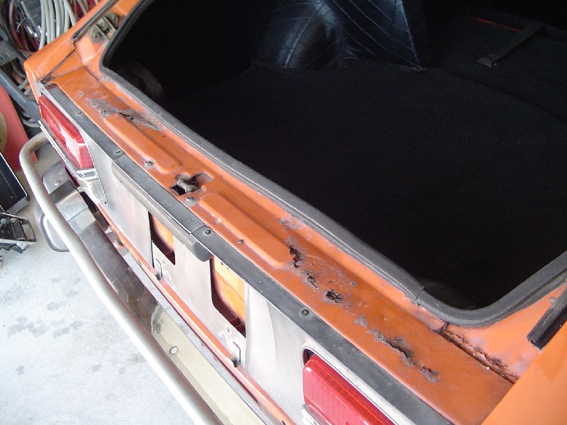

Question is: the lower ledge of the rear hatch is rotted along a line, almost from one side to the other - What's up with that? Any reason why this would seem sensible? And is this an indication of other issues?

Reasons:
1) "T" crossectional joined area of the two panels is naturally stressed and vibration from movement cracks the paint film.
2) Humid exhaust fumes collect in that area(The DS taillight is frequently darker than the PS because of its proximity to the exhaust pipe)
3) Bare steel in the paint film crack+corrosive, humid fumes depositing their chemicals in the crack=steel oxidizing. As area open up due to rust expansion more are to deposit chemicals in, more rust...
Will

My best advice is treat every car like it is a total unknown. Look everywhere. another place that I would especially look at is back into the rear quarters-the corners bordering the area you asked about-frequently the fumes collect in there as well-meaning remove the rear interior trim and get a good look at the entire rear structure from both sides.
One note a car that has been garage kept does get brought into the garage from the rain occasionally, and as most garages are not inherently drafty, effectively become a humidity trap for less humid parts of the country if you let a wet car sit in a closed garage for a month... the water will run where it does and sit-the humidity in the garages means it may not dry in the nooks and crannies. Examine the car just like one from the rust belt-no stone unturned(and no assumptions) means no suprises after you get into the project.

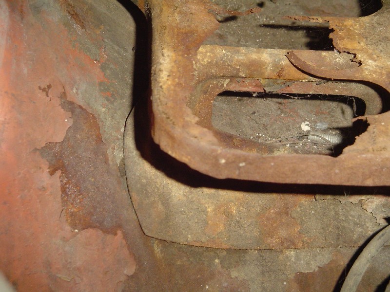

Will's suggestions are great. I'd look at the area under the battery tray too. Battery acid is no respector of climate.

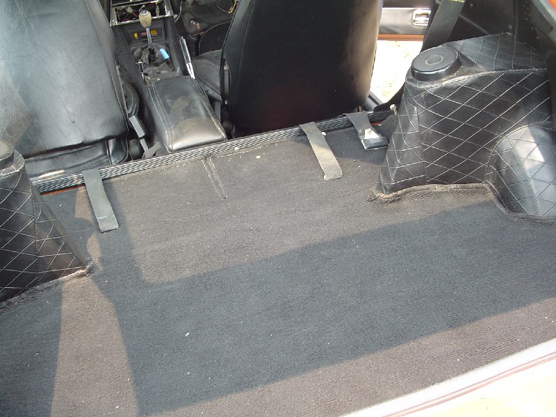

The pictures of the good things balanced out that the rear hatch was an acceptable job if the price of the car was suitable, because as described it was a relatively low milage car and the rest looked very good - paint looked excellent (original), had the original carpet in the back and it was nice. I got a price on the shipping and found one I could accept - preparing to make an offer.

Next thing I get one of the pictures I asked for from the start "the battery tray" (mdbrandy) - it was poor with moderate/heavy rust beneath, next right out of the blue he sends me the compression results: 110 across the board (I have 150 at twice the milage). It was starting to look as if I had misjudged - I lost my nerve and backed out. It still might be a good buy, but including shipping it was too much of a gamble for me.

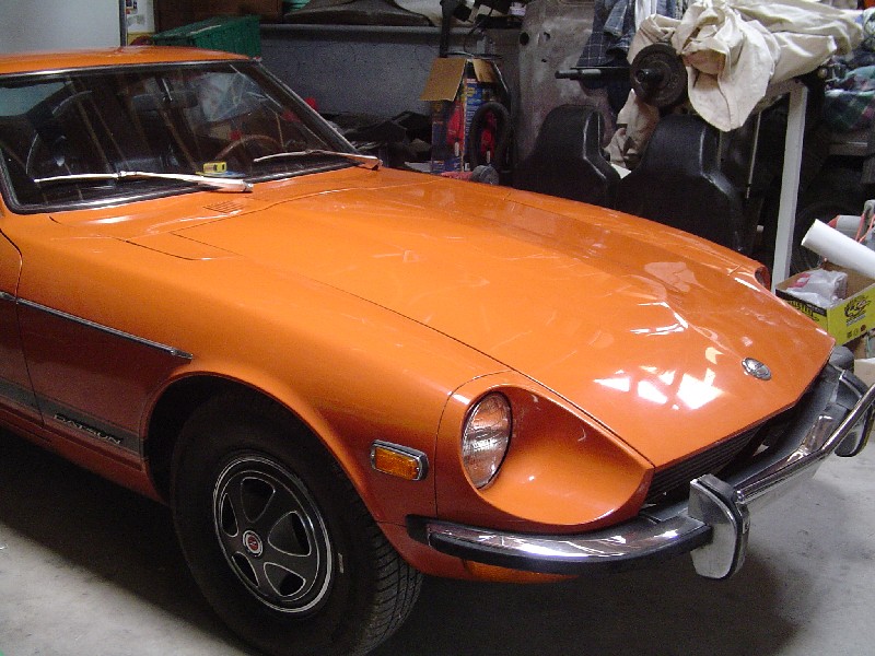

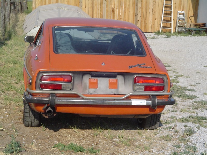

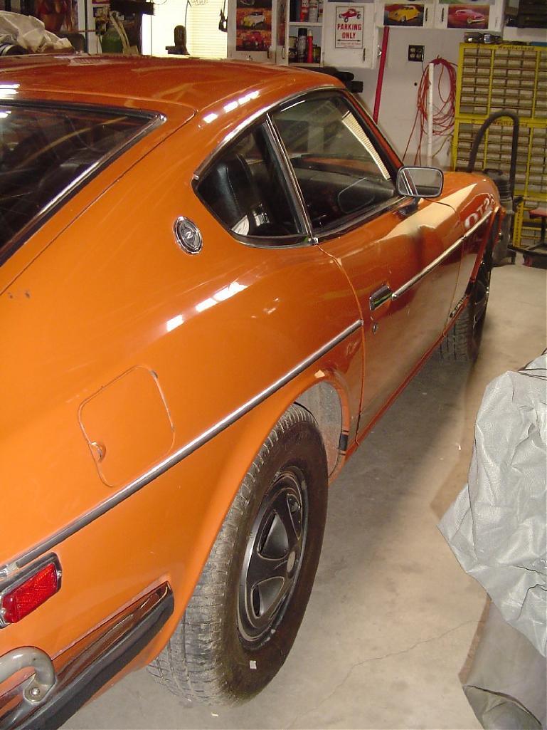

I attached a few shots so you could get a feel for the appearence of the vehicle, so you wouldn't think I was a total tool. It is a looker.

Can you Post the pictures of the battery tray?
Did you find out where is the car was located - PRIOR to its present location. Shouldn't see that much rust in AZ.
