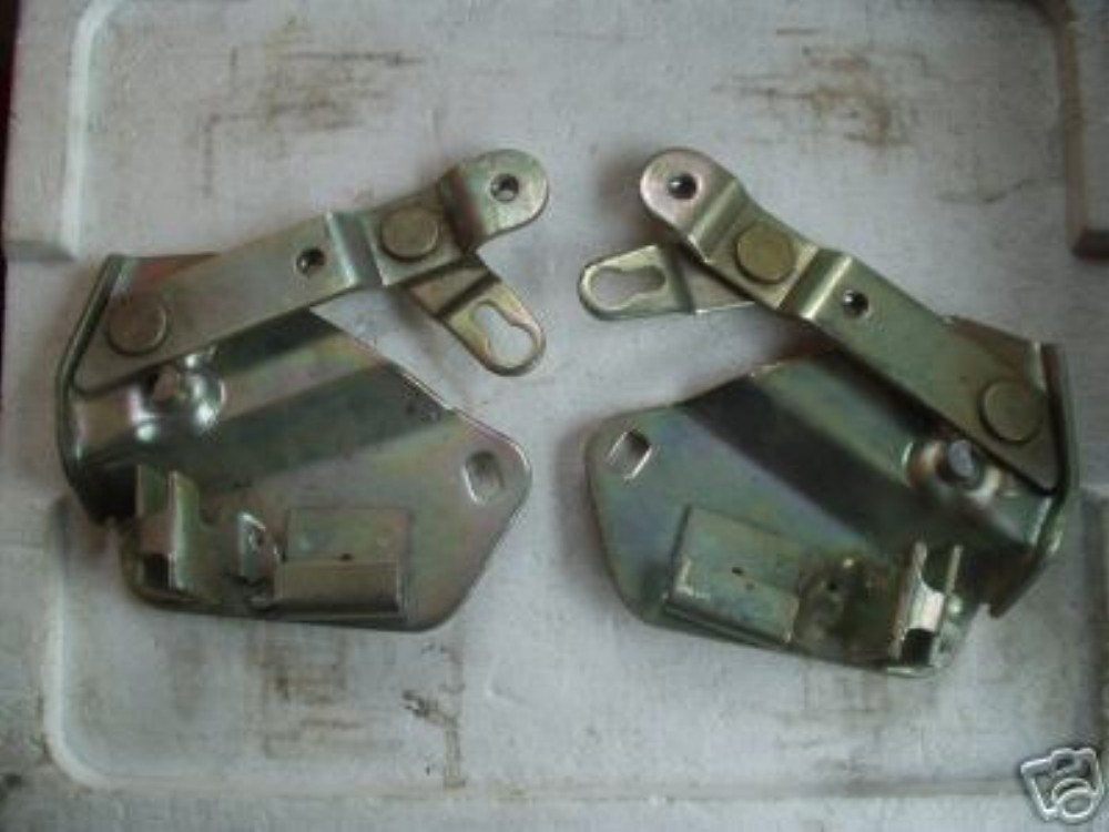

May 15, 200817 yr comment_247468 First pic. from above site. $275 a set. I may be wrong but I'm reasonably sure you can convert the stock hood hinge to perform just like these. I did this conversion years ago but they are not yet fitted to the car so I can't verify that they work as intended. However, if you would like to see some pics. of what I came up with, I'll get some tomorrow. My motives were clear, $275 a set:tapemouth:tapemouth:tapemouth The second pic. shows the pair, side by side. I edited that pic. printed it at 1:1 scale, then rearranged the stock hinge to pivot in the same places:classic: Third pic. is the two types compared. Get rid of the intermediate linkage and VIOLA! Link to comment https://www.classiczcars.com/forums/topic/28116-zg-nose-bonnet-hingeneed-help-thanks/#findComment-247468 Share on other sites More sharing options...
May 15, 200817 yr comment_247472 I used a set of G-nose hinges originals from Japan, the Bad Dog part is an exact reproduction. I am using a few Bad Dog parts in my build and like the quality and service. I was told that the owner is out of town until the first of June, not sure if this would affect ordering the part. If you got the $275 I highly recommend Bad Dog. Link to comment https://www.classiczcars.com/forums/topic/28116-zg-nose-bonnet-hingeneed-help-thanks/#findComment-247472 Share on other sites More sharing options...

May 15, 200817 yr comment_247486 Our hinges are indeed copies of the original (and NLA) gnose special hood hinge. The standard hinge has the hood go out and then tilt up while the gnose goes down and then tilts.Screw up the geometry and your gnose will suffer as a result.The hinges we make are a close to the originals as possible (including the cad plating). The price reflects the quality of the part and the work that goes into making it. Can you modify a hinge to work like a gnose hinge? Yes, without question. Do you want a real gnose hinge? That's up to you to answer.And yes I am out of the country (Persian Gulf) and hope to return in early to mid-June. Link to comment https://www.classiczcars.com/forums/topic/28116-zg-nose-bonnet-hingeneed-help-thanks/#findComment-247486 Share on other sites More sharing options...
