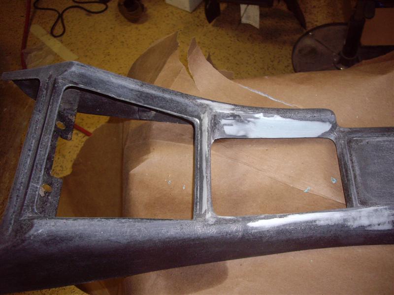

I just did mine with the same paint used to paint the dash...SEM Trim Black. I think it turned out great. I modified my console better fit the 5 speed and I fixed some cracks with a simple 2 part epoxy then filled the cracks and any nicks with body filler, sanded it smooth and shot it with 3 light coats of the SEM product.

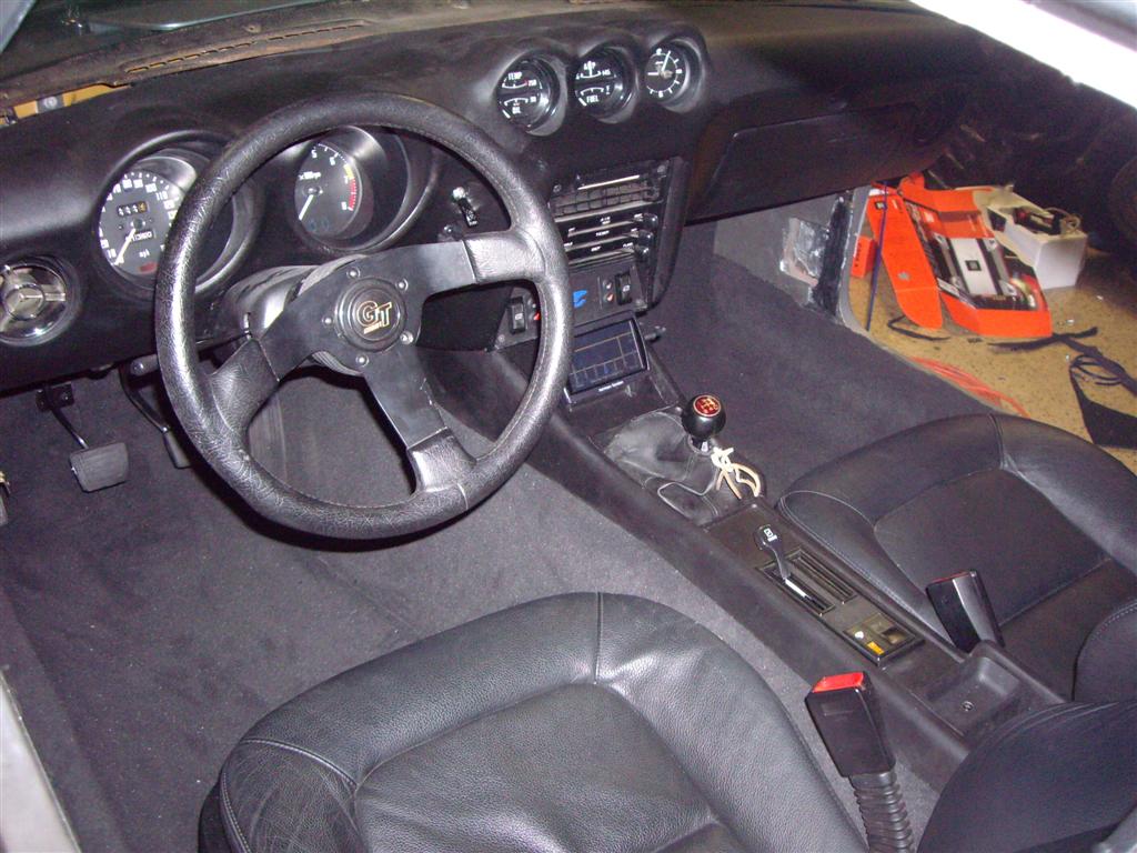

Thanks...that is already done...this is an in-progress picture a week ago. I did not even clean off the finger prints...The seat heaters are working tho as are the power seats and the stereo/GPS/bluetooth/video screen...LOL. There is a lot more to do, but I am shooting for the end of March meeting in Seattle.
