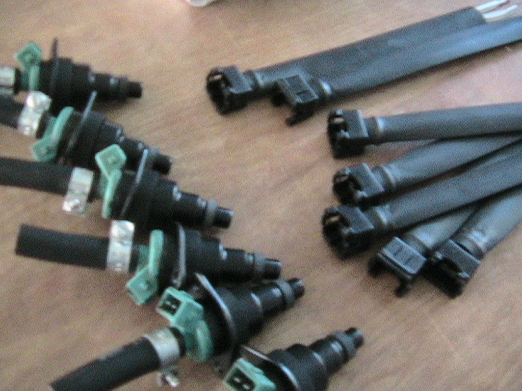

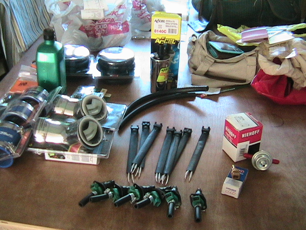

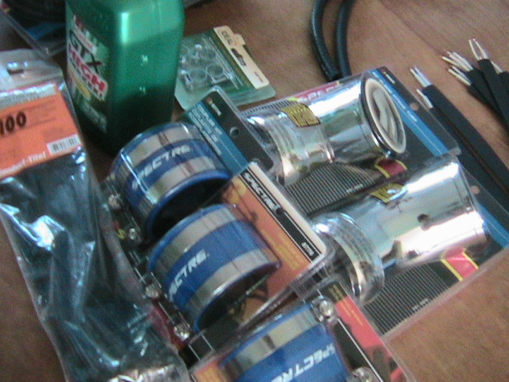

#1-3: The sea of parts I began with... I've been accumulating this stuff all summer, and one final trip to the auto parts store gave me everything I needed... in case you can't see it all, here's what I have in that picture...
1 - Chrome Accel Super-Stock Ignition Coil
1 - Niehoff Fuel-Pressure Regulator
1 - GP Sorenson Coolant Temp. Sensor
6 - Freshly Rebuilt fuel-injectors (all bench-tested and operating perfectly)
1 - Quart of Castrol (for lubricating the injector installation)
7 - New Bosch-style injector connectors
2 - Strips of new fuel-injector hose (rated to 50 psi, such is life)
8 - Fuel-injector hose clamps
1 - Spectre 45-degree air-intake elbow
1 - Spectre 60-degree air-intake elbow
1 - Spectre 3" to 2.5" air-elbow joint thing
2 - Spectre 3" elbow connectors
2 - Plastic electrical 'ducting' tubes... whatever it is... conduit?
100 - Zip-ties

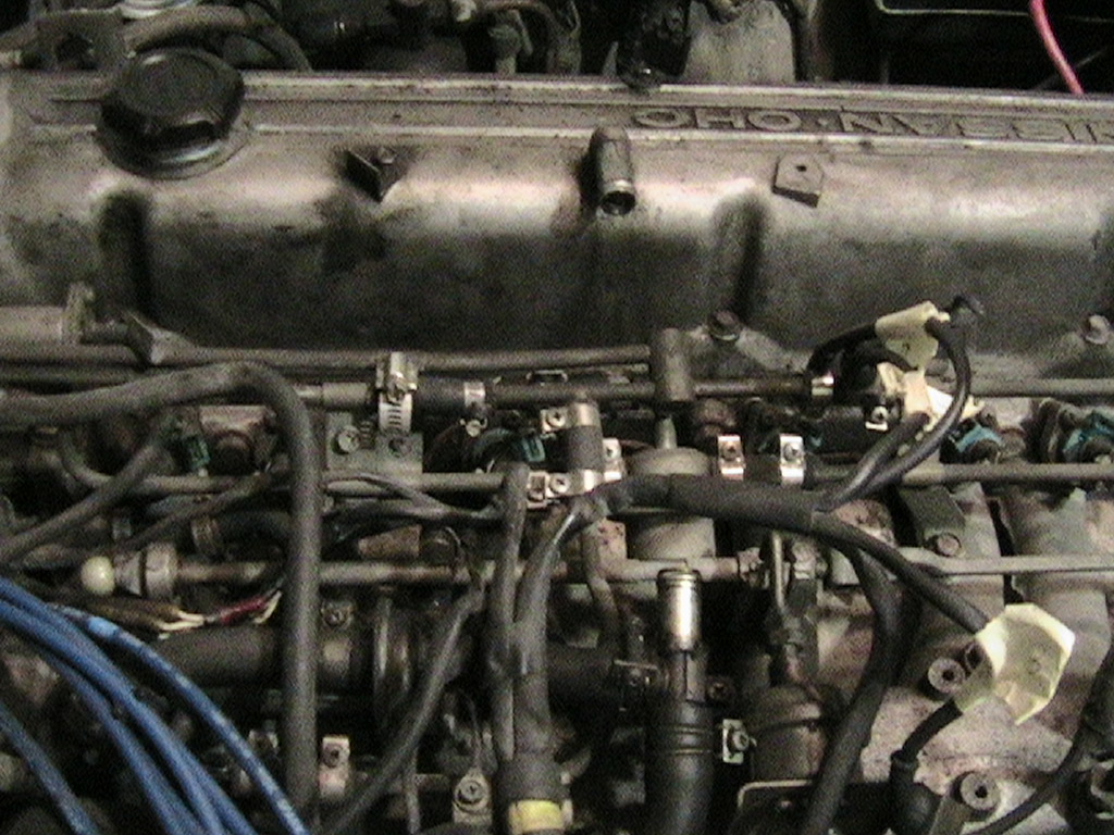

#4: This is a reference picture I took before I tore apart the fuel rail... just in case I got lost in reassembly... I didn't, but it never hurts to play it safe. This also serves as a good 'before' pic.

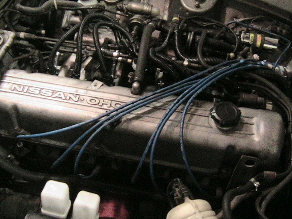

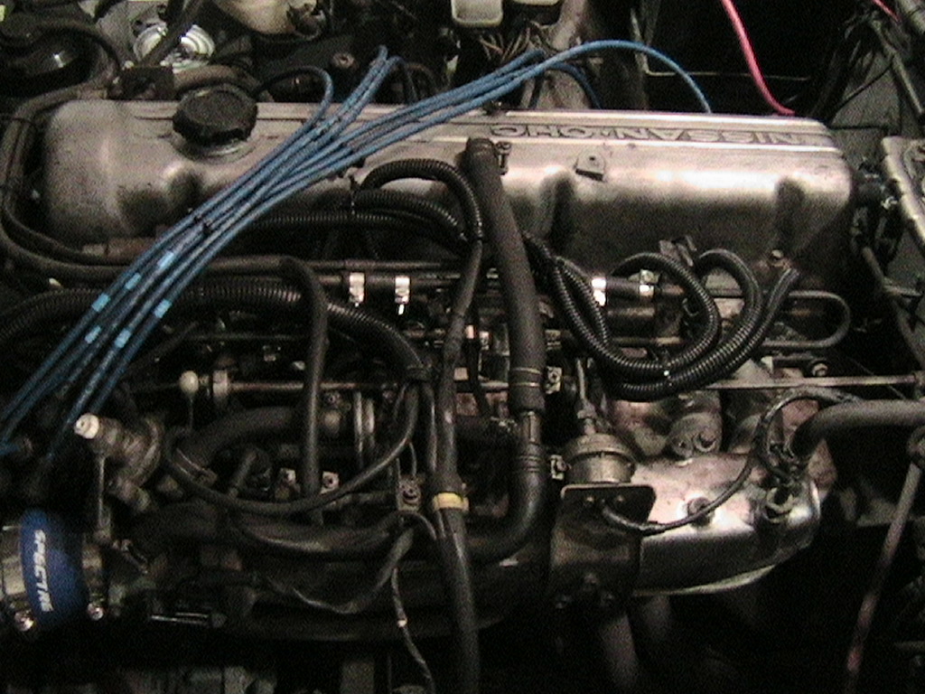

#5, #8: 'After' pics. Doesn't my engine look a lot prettier now?

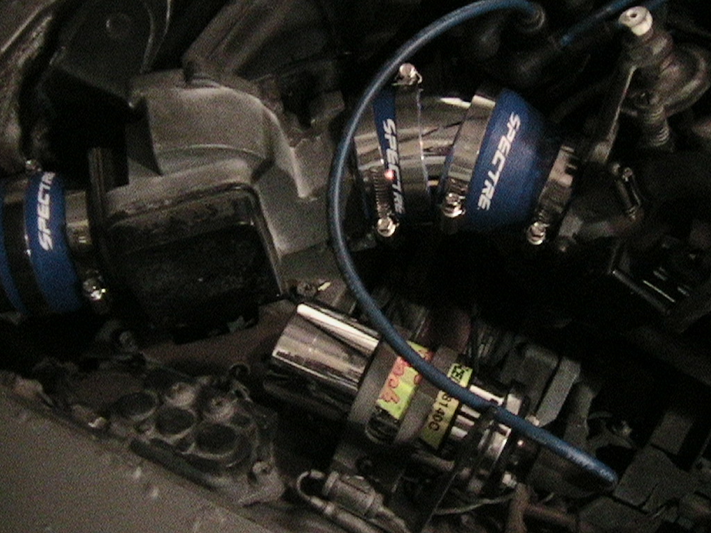

#6: The 'custom' setup I have thanks to those universal Spectre components from Checker. I really had to cut that stuff down (like, a lot) to make it fit in between the throttle and the AFM, but it's there now, and it looks great IMHO! ... and since it's all plastic, no more awkward cracks or sealing issues hopefully!

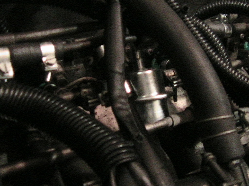

#7 A Close-up shot of that new regulator sittin' pretty in the middle of the fuel-rail. Lookin' sharp boss!
After all was said and done and put back together, soldered and what have you ... all I can say is 'wow' ... A big chunk of my stumbling idle has completely disappeared. She's smoking a lot less than she used to (I was under the belief that my old injectors were leaking while the car was off, and so far from what I've seen with new ones, this suspicion is being confirmed), and really pulls hard in high RPM's ... She's so smooth at high-RPM now it's ridiculous... I didn't even notice that I was taking her past 6-grand!
Two days, and several hundred dollars worth of stuff later... all I can say is... hells yeah baby!! :love: This car!!

The one thing I've noticed though, is that she's still running a bit rich... a far cry from what she used to do, but nonetheless there's still gray smoke. I'm thinking of popping open the AFM to see if there's been any kind of molestation there (there's a few globs of glue around the edge... maybe a sign) ... is there any kind of special glue that I should use for sealing it back up? ... JW :bandit: ... because at this point I don't think there are many components left that deal with the fuel mixture that haven't been replaced... Maaan I'm so close! :P
Silicone should work.
