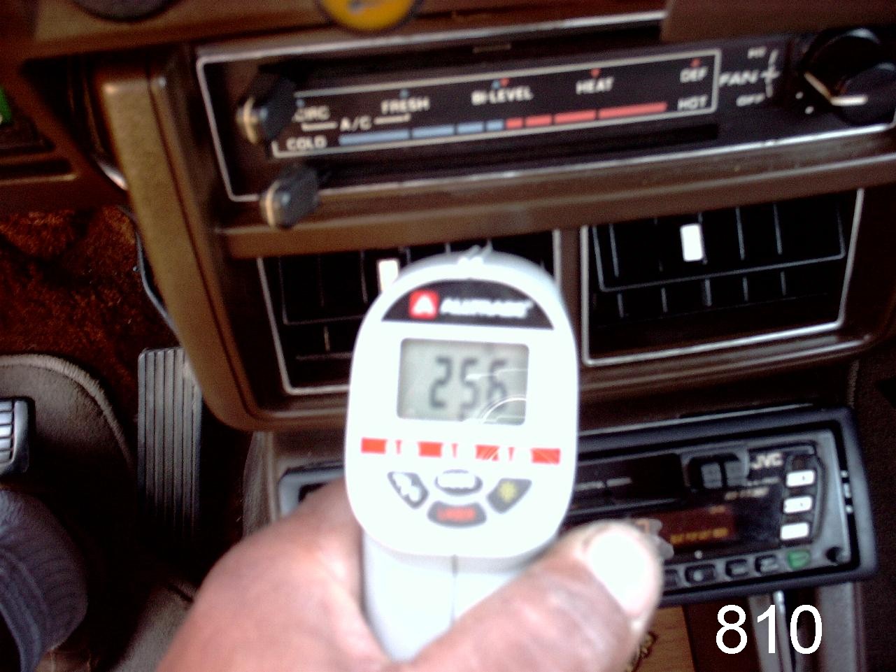

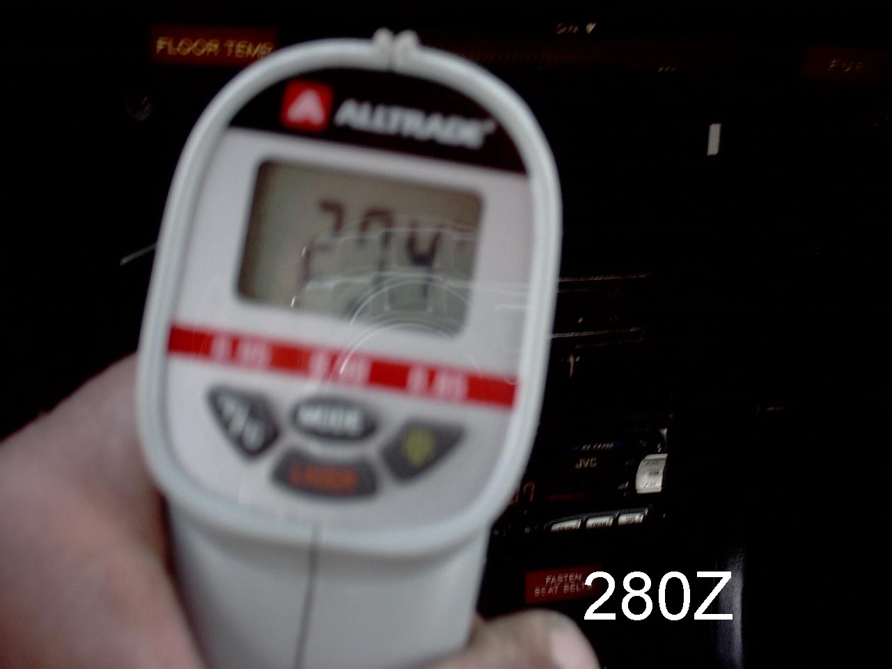

40 degrees at the center vent? Not cold enough.
Yes, but while driving in hot weather. I'm impressed with your 25 degrees. What was the outside temperature that day?
About 90. It doesn't stay at the temp for long because that's about where the compressor will turn off until the evap. temp gets back to above freezing. It will stay basically in the low 30s at the center vent while driving even in temps over 100 degrees at the second lowest fan speed. I was testing on that day for the vent temp I could achieve at idle on the highest fan speed. The 810 which has factory air is a degree or so lower than the Z which has dealer installed air but it's the ARA system with a center mounted evaporator. Those readings were taken about a year ago using Johnson's Freeze12 which is an R-12 replacement. It's non-flamable, non-hydrocarbon, non CFC, EPA accepted, and it works with existing R-12 lubricant. I know that sounds like a commercial but I'm not trying to endorse anything here. I've experimented with a lot of refrigerants over the years and this is the one I use now because it works, hasn't caused any problems in either vehicle in a year and a half of use and costs 1/4 of what R12 costs. It runs at lower pressures that R12, takes less, and cools better. At least, that's been my experience so far.
