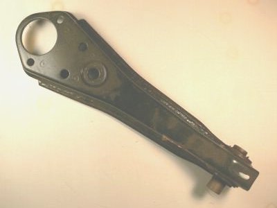

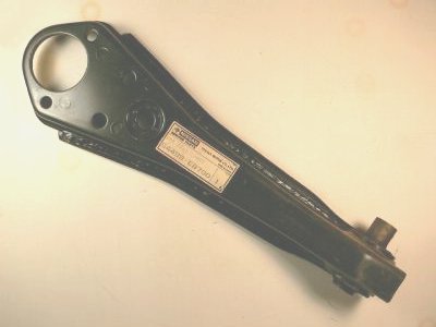

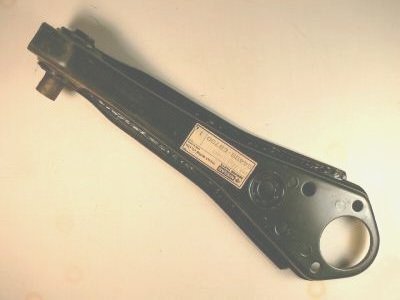

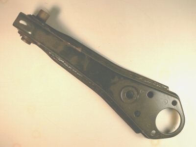

Do they (the bushings) look different than the two pictures attached. I suspect that they probably got the right side 180 degrees from what it should be...
webdawg1
From what i was told, on the pass side the bump is pointing out towards the front, and on the driver side it points toward the back. Am i wrong? Are the both pointing forward? Someone please make this a little more clear :) In your pics it looks like they both point forward. . . am i wrong?
I believe I have my pictures labeled wrong. Checked on the bushings as installed in the car...out in the garage. On my 75 280Z they are both pointed to the back (I.E. - Long part of the bushing pointed to the back part of the car)
webdawg1
so they should BOTH be facing backwards? the thicker part should be facing the rear of the car? Becasue MSA said the pass side should be facing the front of the car? I'm very lost right now. :) haha They even showed me a stock LCA for the pass side.
Yes. That's how they are on both my cars.
