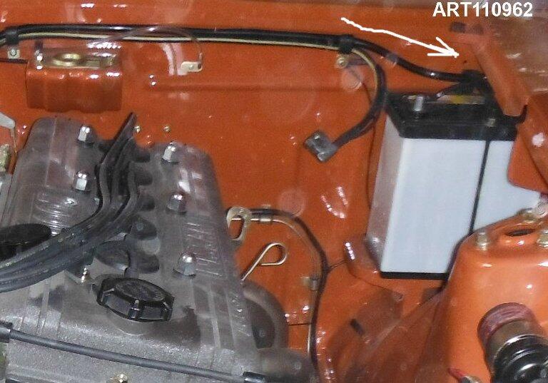

Many thanks, Alan.  I examined maybe 20 engine bay photos of Z432s, and pretty much every car owner had at one point changed the stock positions to something other than your photo.  Many had also swapped around the battery terminals, probably to ease access to the extra power runs for whichever replacement ignition system they were using.   My car is no exception.

Well, I can't make it as clean as the sample model provided up-top, but it's at least better than it was.  There's a myriad of conflicting moving parts right where these wires drop down behind the engine, and I'm just now noticing the bracket which helps hold them away from the cowl was bent out of position by the previous owner, causing me to wonder how to solve the clearance issue.  Some more work to be done on that side, including moving the wires to the other side of the choke cable.

Stock PS30 battery cable routing should be very similar to stock S30 and S30-S battery cable routing for cars made during the same period.
The two cable run from the battery, along the firewall at the same level, over the top of the bonnet/hood catch bracket, and then turn down towards the bellhousing and starter motor - with their last holding point on the firewall being the dedicated stand-off clamp which is quite similar to the Mater Vac hose bracket. Small bolt-on clamps hold the cables to the firewall.
I think people started routing the cables through the catch bracket because it acted as an extra guide, and perhaps looked a little neater. Strictly speaking, it is not correct.

I need to look how my Z432 has them . The small bolt-on cramp should be three for Z432  , four for all the other RHD S30 series .
Kats
Apart from the standoff by the throttle linkage (which I've now wrestled sort-of into place), I have 2 clamps just under the cowl, with a possible location for a third by the positive battery terminal, under the inspection lid. But that's the only place where I can see where a third clamp could go. You can just see the bolt hole on one of Alan's photos.Is this correct?

On 2/18/2022 at 7:27 AM, xs10shl said:
Looking at Z432 battery cable routing.  Mine has clearly been monkeyed with, so I want to fix it.  Based on some stills I can see from your car, Kats, it's different from what a standard S30 RHD is, in that your negative is routed along the top of the cowl (where the positive would be on an S30), and the positive is right below it, and going through the hood release latch mounting.  Is this actually how they routed it? or perhaps I'm looking at older pictures of your car? (btw, that how the previous owner routed mine, but the number of zip ties used make me think that its probably not factory.)
I reviewed  my Z432 engine room, I found the battery cables we’re going through over the top of the bonnet catch basement during restoration, but I changed it at some point without any knowledge.
And still now it is very fun digging into originality, I want to see a lot more examples to nail it down.
The picture from the Service  Shuho shows the car doesn’t have the stand -off bracket , instead of that , there are two clips which is used also for L-series engined car. I can’t do the same thing because this car could be a very early one like production prototype cars . But I can see what is needed for S20 battery cable routings from this picture.
As you can see , S20 requires different throttle linkage which is obstructing battery cable routing for L20/L24 engined cars.
Kats
Edited by kats
I have something to be clear, for Z432 , parts catalog says three bolt on brackets, four for other models. So , looking at my car and PS30-00055(Dec 1969) , both have three welded nuts which seems serving for the cables on the fire wall .
Then I thought I need to put #3 bracket just below the choke cable grommet (please see my post above).
But , I am feeling something uneasy. Both cables should be clamped by the stand -off bracket, shouldn’t be? My idea for the negative cable routings doesn’t look right day by day .Nissan engineers intended to clamp both cables didn’t they ?
And seeing the red PS30-00055 and other Z432 , the #3 nut looks never used . Even my Z432 would have never used it.
So , why parts catalog says three bolt on brackets ?
Interesting!
I agree that the PZ-specific stand-off bracket was designed to hold both battery cables at that point (in order to route them away from the accel linkage, as you say). I see many stand-off brackets that are bent up and misshapen (probably because owners/mechanics were seeking access to the accel linkage) and the bracket needs to be in its original shape to route the cable properly. I have also seen variation in the cable earthing point (again, probably due to actions of owners/mechanics) so that will also change the routing...
About that mystery third clamping point: How about the captive nut on the firewall which is right over the battery? I feel like it is ideally positioned to hold ONE battery cable as it comes off the battery terminal - the one furthest to the outside of the car on the left - but seems rarely used. Possibly because of different batteries being retro-fitted?
