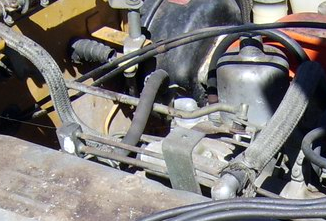

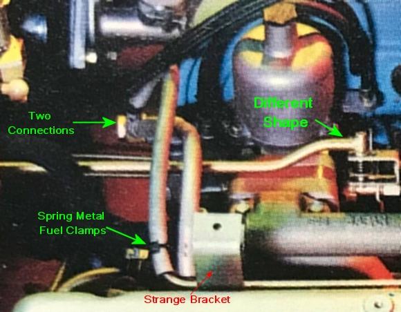

June 5, 20187 yr comment_550461 Hi Kats, Another mystery ? I re-coloured one of the red photos from the service manual. I hope you enjoy it. In doing so, I noticed two unusual features that did not make it to production. 1. The fuel rail to carb hoses are very light in colour (not black). 2. There seem to be three of these hoses coming from the rail rather than just two. ( 1 to the front fuel bowl, 1 to the rear fuel bowl, 1 that seems to go to the fuel bowl area [see second picture]) Any idea on what material the hoses are made and the purpose of the third hose? Edited June 6, 20187 yr by 240260280 Link to comment https://www.classiczcars.com/forums/topic/23900-datsun-240z-vs-fairlady-z432/?&page=89#findComment-550461 Share on other sites More sharing options...
June 5, 20187 yr comment_550462 Perhaps it's a fuel line to run cool fuel through the intake to help lower intake temps? Like the cooling bodies on Mikuni / Solex carbs? Link to comment https://www.classiczcars.com/forums/topic/23900-datsun-240z-vs-fairlady-z432/?&page=89#findComment-550462 Share on other sites More sharing options...

June 5, 20187 yr comment_550465 2 minutes ago, Gav240z said: Perhaps it's a fuel line to run cool fuel through the intake to help lower intake temps? Like the cooling bodies on Mikuni / Solex carbs? Good point. I recall a coolant hardline that wrapped around the back of the head for running coolant through later manifolds but did it terminate so high up where the fuel rail is and was it on early models? Link to comment https://www.classiczcars.com/forums/topic/23900-datsun-240z-vs-fairlady-z432/?&page=89#findComment-550465 Share on other sites More sharing options...
June 6, 20187 yr comment_550497 10 hours ago, 240260280 said: Good point. I recall a coolant hardline that wrapped around the back of the head for running coolant through later manifolds but did it terminate so high up where the fuel rail is and was it on early models? No it didn't, I was really just guessing as to it's use. I thought it may have been an older method of fuel return line, but I see that's still there on this early prototype. So I can only guess maybe it was an attempt to run cooler fuel through the carb bodies before returning to the tank? I know the Mikuni's have this ability, but few actually utilise it. Link to comment https://www.classiczcars.com/forums/topic/23900-datsun-240z-vs-fairlady-z432/?&page=89#findComment-550497 Share on other sites More sharing options...

June 6, 20187 yr Author comment_550513 Hi Blue , I was surprised you are doing it , how can you do it ? It helps a lot for understanding its details , original photo is not good to figure out what each pieces are . Here are the color pictures , and the one showing the engine bay looks the same car what we are talking about . Could you see the float has two pipes at one connector? Kats Link to comment https://www.classiczcars.com/forums/topic/23900-datsun-240z-vs-fairlady-z432/?&page=89#findComment-550513 Share on other sites More sharing options...

June 6, 20187 yr comment_550532 9 hours ago, kats said: Here are the color pictures , and the one showing the engine bay looks the same car what we are talking about . Could you see the float has two pipes at one connector? Kats Thanks for the high resolution! Here is another find. The inlet on the fuel pump is on the front and outlet is inboard. Also the exit hose the pump is light colour. I'll dig some more ? HLS30-00013 Fuel Routing. Edited June 6, 20187 yr by 240260280 Link to comment https://www.classiczcars.com/forums/topic/23900-datsun-240z-vs-fairlady-z432/?&page=89#findComment-550532 Share on other sites More sharing options...

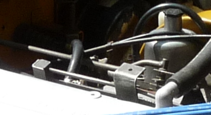

June 6, 20187 yr comment_550533 The more one looks, the more one finds ? Here is fuel rail on HLS30-00249 in that area. Throttle shaft looks the same but the bracket is closer to the middle of the engine: HLS30-00013 looks the same as #249 Edited June 6, 20187 yr by 240260280 Link to comment https://www.classiczcars.com/forums/topic/23900-datsun-240z-vs-fairlady-z432/?&page=89#findComment-550533 Share on other sites More sharing options...
