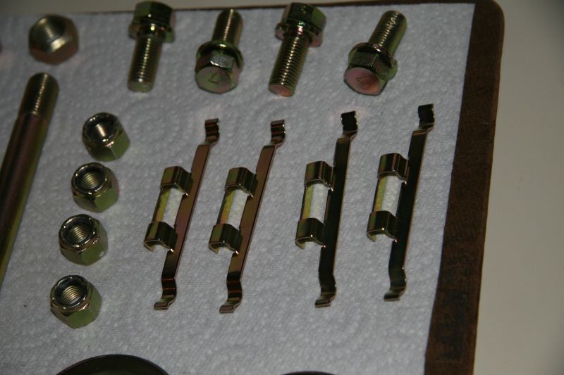

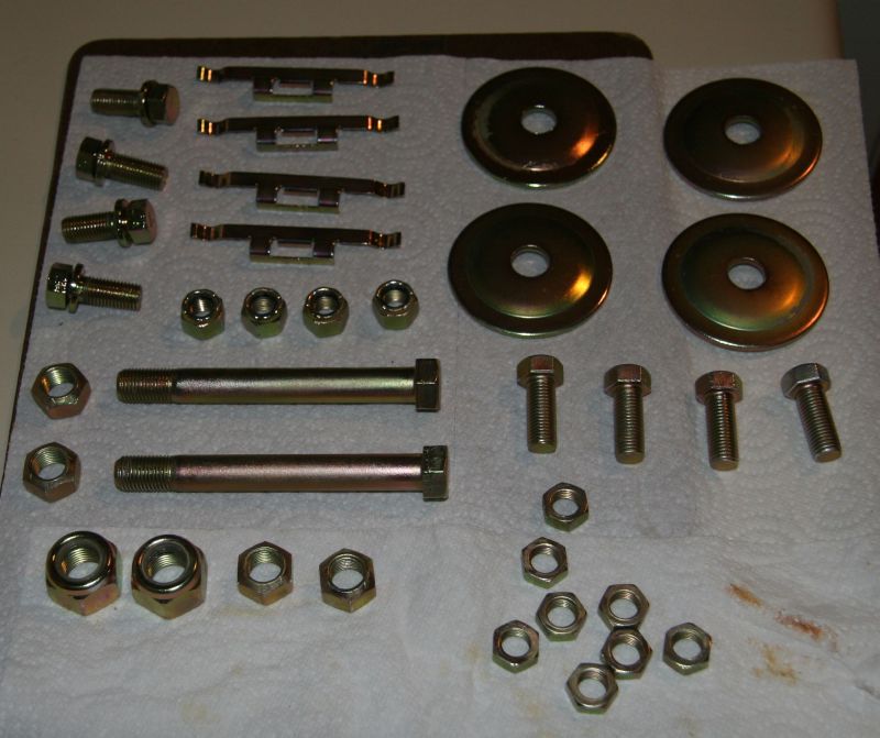

Posted April 3, 200718 yr comment_204566 Well I'm getting very close to re-assembly time after refinishing all of the suspension parts and fasteners. Just a few more items to aquire to complete the suspension refresh/brake upgrade. Long story short; after paying someone to bead blast all my suspension parts and doing a nice job painting everything very carefully with a rattle can ($300 blasting, $~100 paint & supplies), I decided I wanted to go ahead and have it all stripped and powder coated. To my surprise, I was able to get it all bead blasted and powder coated for roughly the same ($375) cost as the original finishing job. Woohoo! And boy does it look great! I should have gone this route in the first place. Live and learn. The part clean-up was a bit harder with the powder coating, but definitely worth it in the end. The list of 36 parts that were plated for $375 are listed below. Was the latter a good deal or not? Also, I'm just about finished zinc plating the original fasteners with the factory yellow chromate finish, although I like the finish just a bit darker than the factory finsh. I knocked off the rust and corrosion using a wire wheel, and then put them all into a bath of hydrochloric acid to take them down to bare steel. The next step was the plating which was a real learning process. After a couple weeks of experimentation and two different rectifiers, I was finally able to come up with a repeatable process and formula that got me the finish I was looking for. I used the Copy Cad kit from Caswell for the zinc plating and the Yellow Chromate formula for the color. This is a very time consuming process. Unless you are simply interested in trying this for yourself out of curiosity, I recommend taking everything to a professional plater. Probably cheaper if time is $$$$ to you. That said, I'm still glad I did it myself. Looking at the finished product and knowing I did it myself is very satisfying. Pics below. The last items (that I'm aware of) I need to complete the brake upgrade are the front and rear disc brake conversion adapters and cross drilled rotors, but getting these items is proving to be a bit of challenge due to a possible communication problem. Anyone have Ross's telephone number? . . 2 - Front Transverse links 2 - Steering knuckles 2 - Front Strut Assy 2 - T/C Rods 2 - Front Hubs 1 - Front Crossmember 4 - Front Crossmember - special washers (upper/lower) 2 - Steering rack mtg brackets 1 - Steering rack mtg u-bolt & bracket 1 - Front Sway Bar 2 - Front sway bar reinforcing plates 4 - Front/Rear upper spring seats 2 - Rear transverse links 2 - Rear Strut Assy 2 - Rear Transverse Link Braces 1 - Rear Transverse Link Member 2 - Rear Transverse Link Mtg Brackets 1 - Differential Mtg Member 1 - Rear Sway Bar --------- $300 - Blast and coat - Good deal or not? . . Link to comment https://www.classiczcars.com/forums/topic/23820-refinishing-change-of-plans-and-progress/ Share on other sites More sharing options...
April 3, 200718 yr comment_204580 Nice and shiny. Great work!!!I heard once that nylocks should not be re-used due to the fact that the nylon won't bite the thread as well the second time around. Maybe worth a look at getting new ones???? I'm not sure, anyone else heard anything about re-using nylocks?It might be an idea to use some Loctite thread locker if you re-use them. Worth a thought. Link to comment https://www.classiczcars.com/forums/topic/23820-refinishing-change-of-plans-and-progress/#findComment-204580 Share on other sites More sharing options...
April 3, 200718 yr Author comment_204600 Yes, I've heard the same thing, however these seem to be in good shape and provided enough resistance when re-installing so I'm not too worried about it. I ordered replacements anyway and intend to replace them with the new ones once they have been re-plated and finished in yellow chromate. Link to comment https://www.classiczcars.com/forums/topic/23820-refinishing-change-of-plans-and-progress/#findComment-204600 Share on other sites More sharing options...
