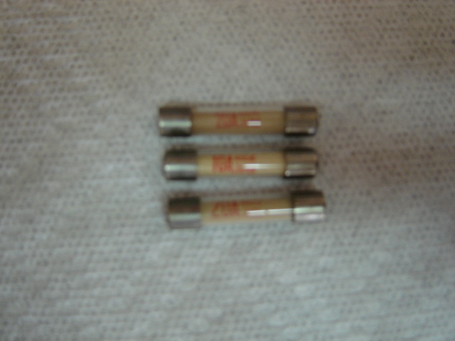

I know this is a pretty mundane question but can anyone tell me when this type of fuse was last manufactured? Are they still being manufactured? These are the types of fuses in my fuse box. Sorry about the crappy picture but these fuses have a small strip of paper on the inside and it says Niles, Japan and lists the fuse amperage

Based on what you said above, I'd bet those are original fuses. Maybe Carl Beck or Chris Wenzel can chime in on that though. Carl bought his Z new and may remember what factory new fuses look like.
I personally have never seen anything but the ones we're all accustomed to seeing.

My late '71 had 59,500 miles on it when I bought it last fall. I am the third owner. None of the existing fuses have the paper in them. So if the paper type are original, all of mine have been replaced in the ensuing years, which seems more proactive than my car's prior owners typically were. Not that they ignored things that were necessary, they didn't - if it needed something it got it. But if something wasn't broke, it stayed. For example, they never replaced the original dated plug wires or cloth-covered hoses in all those years. (I'm not complaining, that attitude really helped maintain the originality of the car.) So replacing every fuse (including the hidden ones for the blower, defroster and radio) at some point seems out of character for them. But it could certainly have been done.
But on a related note, many of my fuses also have different constructiion than those that are available today. Mine look like modern fuses, but the metal end caps are visibly soldered on. The flat ends are soft solder, not smooth steel like the modern ones. Not sure when that method was used. But I've had one fuse failure because of the soldered ends - the blower fuse was very intermittant. I found that the soft solder ends had dimples worn in them from the spring loaded terminals in the fuse holder. A new fuse fixed the issue. But that fact that the ends were visibly worn leads me to think that soldered fuse had been in there for a LONG time.
An additional thought - the paper having the country of origin maked seems a bit odd to me for 1970. I don't think that marking was common then.
Niles made many of the electrical components on the Z'z----flashers, bulbs, sockets, relays, etc. and probably made fuses as well---
I have one fuse from the fusebox of my 7/70 with the inscription on the strip of paper inside the fuse that reads:
20A PEACE
JAPAN
In front of the word PEACE is a lightning bolt
(The word Japan is under the word Peace----I couldn't get this spacing to come out right on this post)
I would speculate that there was a PEACE Electronics Company in Japan that made them. They are constructed just as Arne described with the soft solder filled end caps .

This is a fuse block I bought I think in the late '80's for a '72. With this, I don't think what you have is original.
