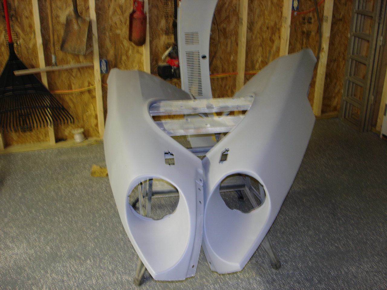

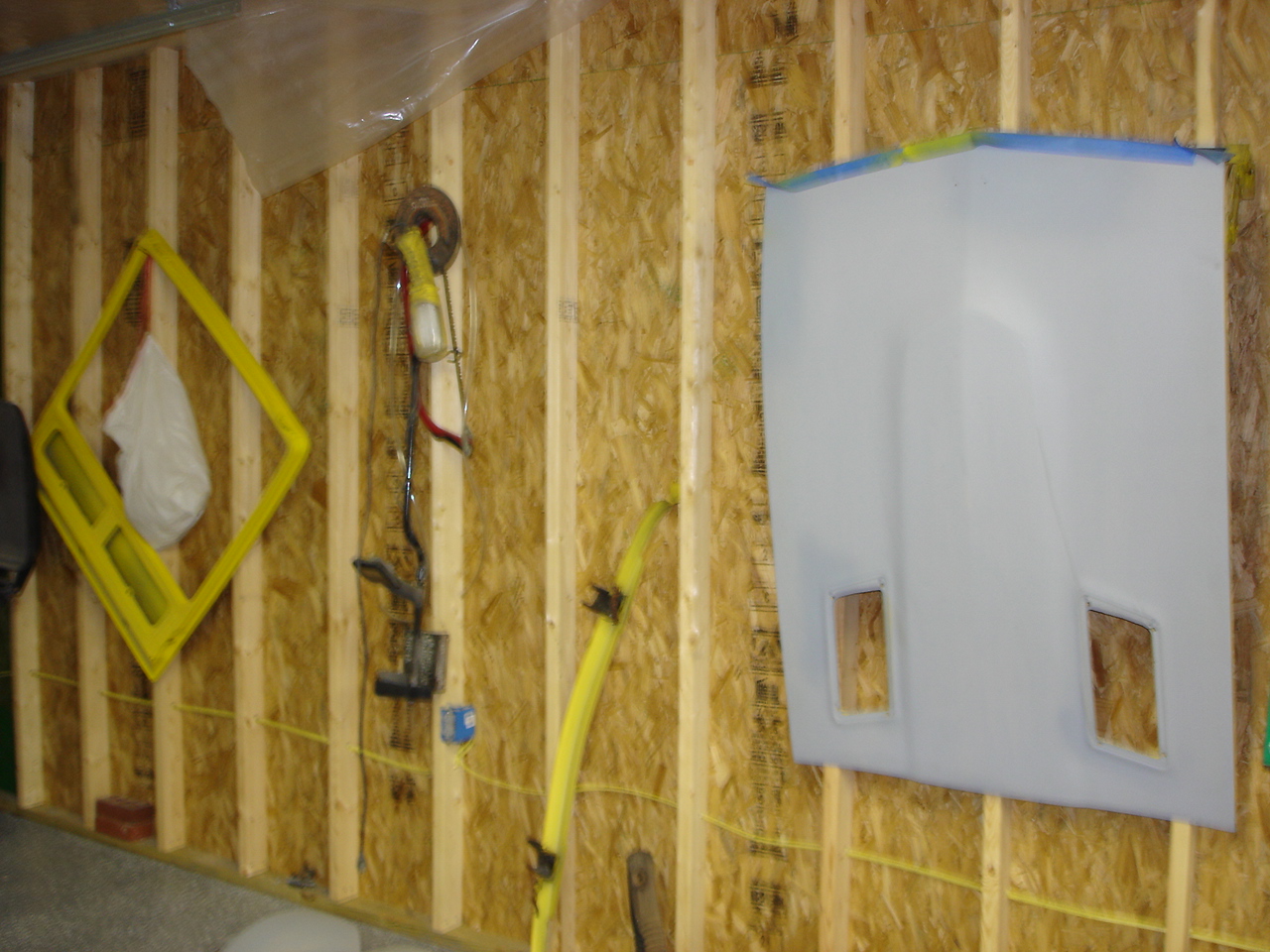

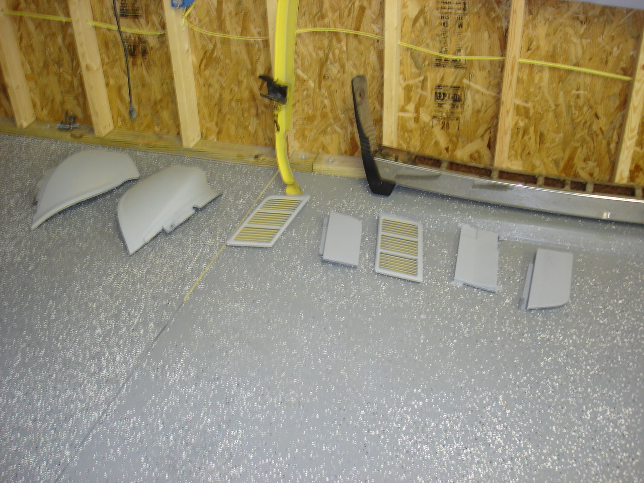

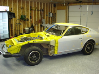

Well a big thank you to all you guys for the "coaching" along the way. Think I have gathered enough info to give it a go. here are a couple "BEFORE" pics. gonna be in the 70's this weekend, think it is time!!! Been talking to the paint rep from napa (guy that services all the paint and body shops) and here is my intentions.
first step is WHITE TINTED SEALER, not a primer sealer cause I used rattle can duplicolor high build primer and he said that is laquer based and could have an issue spraying primer sealer over it!
second step of course base coat, getting a gallon so should have lots with left over.
then clear coat, all are supposed to be ureathane based! got to go start taping things off! Oh already did single stage in engine compartment underside of hood and underside of hatch for those that have been following along! And yes I did end up tacing the buckets to fender and hiding the seam! Why, Just because!!!
