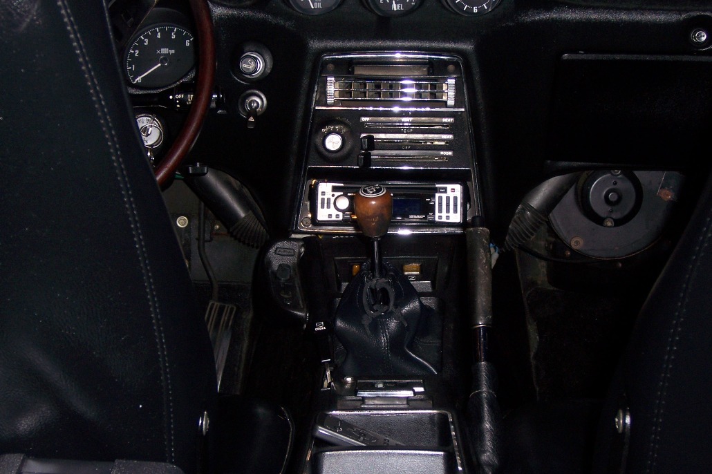

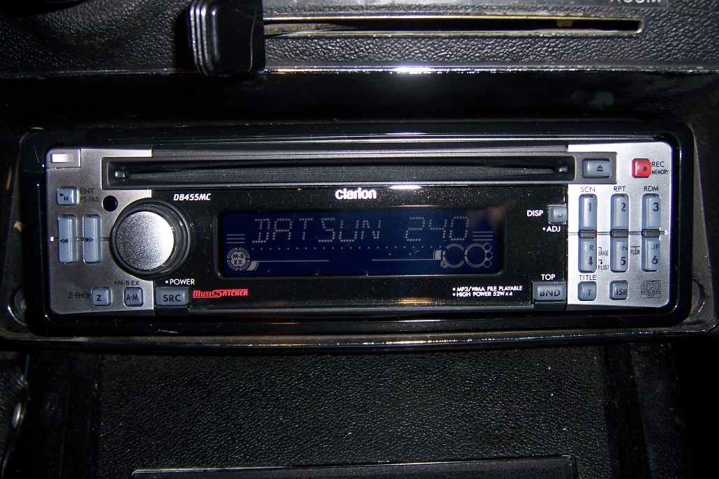

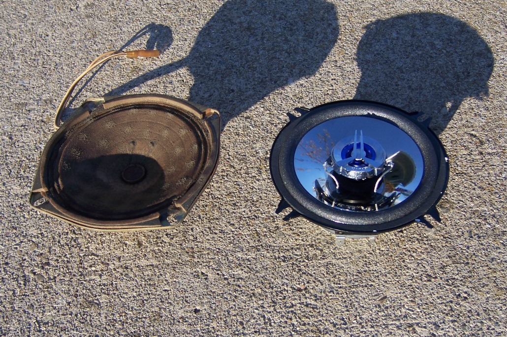

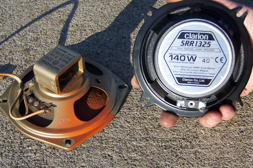

When I pulled mine apart I found the original 5.25" Hitachi speaker hanging out but disconnected. The PO had hacked up the door panels for some crappy 4" Pioneers and installed a Panasonic Tapedeck. I have since replaced them with an awesome Clarion AM/FM/CD/MP3/WMA with built in Flash Memory to hold a few hours of music... It's sweet! I pulled the Pioneers for new Clarion 4" in the doors HUGE difference worth every penny. Where I ran into issues was trying to replace the original 5.25" with new Clarion 5.25" 3 ways in the rear. First I was going to have to make a braket for the passenger side, and second the Tweeters stuck out to far from the speaker and made contact with the interior panel causing crazy buzzing from the vibration. Plus those locations are not conducive to good sound. I intend on purchasing the 6x9 speaker panel from MSA or making my own or to accomodate two 6.5"s ... maybe?
