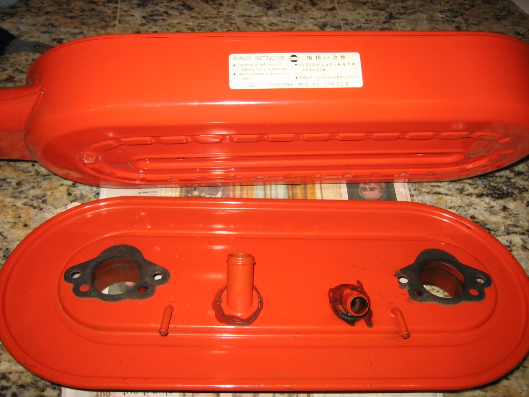

I just received the airbox pictured below. I purchased on ebay from this auction:
http://cgi.ebay.com/ebaymotors/ws/eBayISAPI.dll?ViewItem&ih=017&sspagename=STRK%3AMEWN%3AIT&viewitem=&item=270045999157&rd=1,1
(yeah it cost alot but still less than a refinished one from ZTherapy and it really is in perfect original condition - I hope)

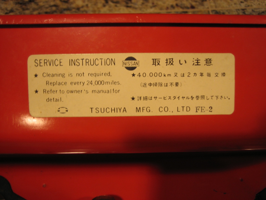

My question is: The lone sticker on the top of the box seems to be in an odd location and it lacks the larger 'silver' sticker that shows the position of carb screws and such. Is this a match for an early series 1 air box? I assumed they all had the larger silver sticker as well....

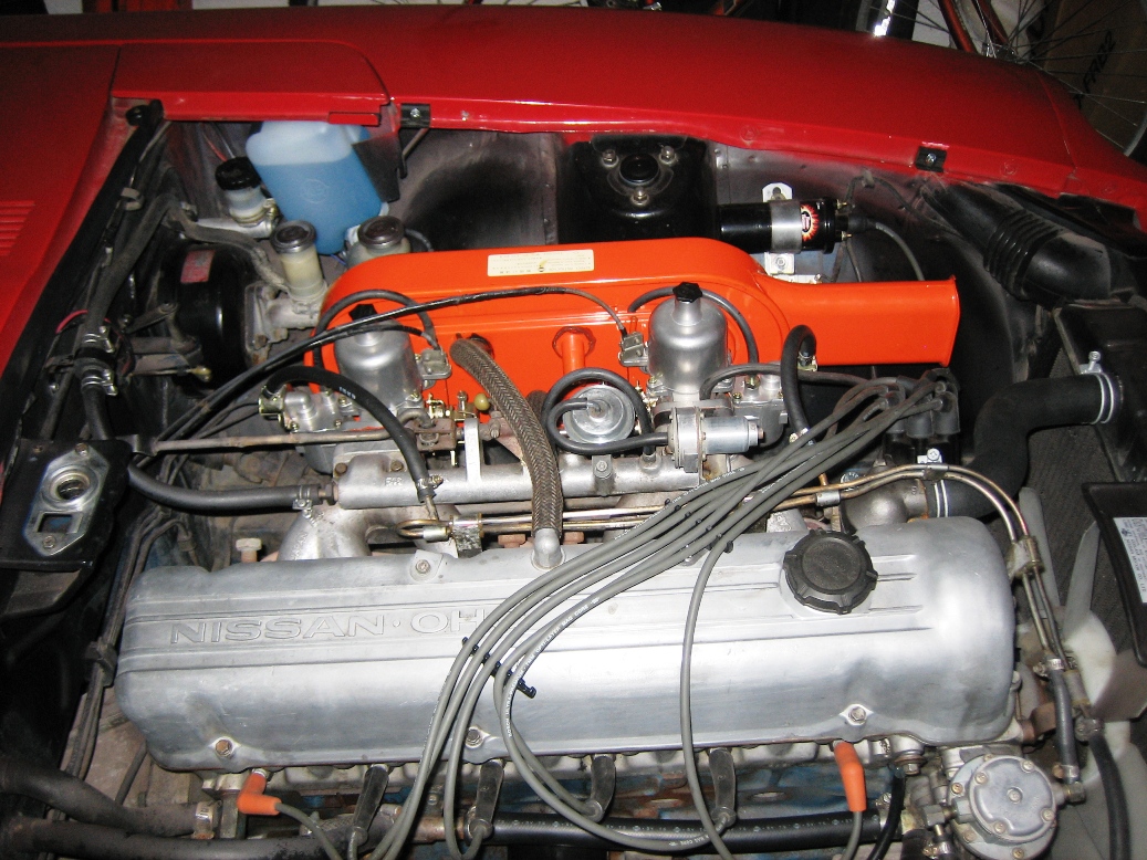

While I'm at it I am excited by the progress in my engine compartment so I have posted a pre-purchase 'before' picture and a picture of it now for your enjoyment. I don't plan to pull the engine and properly repaint and such but for working around the edges I think it is coming along!
Looking good Derek. Are those some new Ztherapy carbs I see on there or did you just refersh the old ones yourself? Even better question, how's it run?

I think that you are correct. The housings without the manifold heat flap on the air horn, early cars, should have two decals. It would appear that your lone decal is probably original, something you would definitely want to keep, although its placement might not allow room for the larger silver tune up decal.

Those are new ZTherapy carbs. Combine them with a tune up and valve adjustment and once she's warm she runs perfectly....

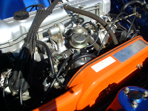

Still wondering - has anyone seen a box with the sticker placed like this? I use the attached pic as my guide for perfect super early Z(from kats)......
Any other perspectives and any idea what the little FE-2 in the bottom right corner of the sticker means? It looks like a little stamp - not part of the standard printing on the sticker...

I've installed the two stickers on my air cleaner housing the same way you have it pictured from Kats. I looked at as many pictures as I could trying to get the consensus on where they were installed and I saw this configuration several times. Hopefully it's correct.
On the FE-2 stamp. I'm speculating here but it's not uncommon in manufacturing to have someone place a "stamp" on a part, an assembly or some other feature on the product to signify it has been inspected and accepted. The stamps are typically unique to an individual Inspector. However, since Deming had such a strong influence on the Japanese and he was against product inspection in general, who knows where it came from.

Early Japanese home-market ( L20A engined ) cars did not always have the silver sticker. They often had just the Tsuchiya filter info sticker, and the very earliest press and show cars had no stickers at all.
My feeling is that you might have purchased the combination of an NOS Japanese-market outer casing and the HLS30-U type back plate.

"Derek, I've had some time to ponder your air filter housing and I think it is a late 69 (11 or 12)or early 70 (1), US market, unit. I'm assuming that the 2 halves belong together. Having said that, the fitting for the air pump hose is present which would rule out Canada, UK, and most of the rest of the world. Why it has the one decal in the center, not sure. Important to remember that cars weren't manufactured to anything like the standards in force today. Maybe that day the line was out of the large silver one? FE-2, maybe a lot #? Mike "

The outer half of the housing is brand new, never used. The paint is beautiful, glossy and original. This piece has not been restored. In the pictures the outer half looks to be dented on the bottom but it is not.
The inner half of the housing is used. There might be one or two small scratches in the paint but it is still clean, glossy and original. There are no dents or oily smudge marks.

Derek, I am assuming that Mike didn't know that the back plate was a used item as opposed to the front that is new. Therefore they are not a matched set per se and the front cover could still be from another market.
