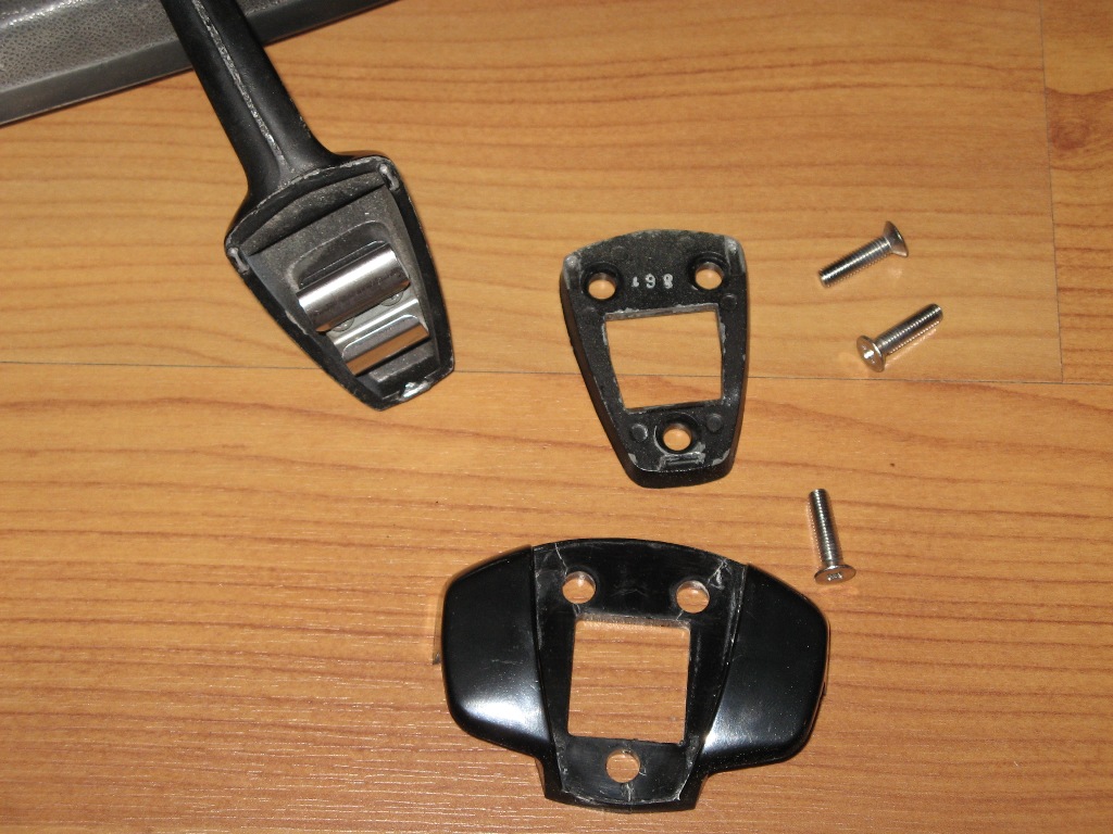

The base of the mirror snaps into a square hole in a metal clip that is in turned covered by the plastic piece that holds the sun visors. The three screws go into the metal piece which actually holds the plastic piece in place. It's possible that the plastic part is broken off and missing but the metal is still there.

I wish I could answer that but it appears that once again I'm a victim of not knowing of production changes to items like this. I'm really only familiar with what's on my 9/71 model. I had no idea that this ever changed. I've attached a picture I just took of mine that clearly shows the separate pieces. As you can see my plastic piece was actually cracked and broken and I used a plastic glue to repair it.
I did just attempt to install just the metal piece without the plastic but in that situation the square hole is not deep enough to accept the mirror; the clip on the mirror hits the vinyl.
