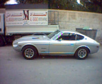

I don't know what to say, I just put the car down on the road and I was surprized that the car looks like a boat! it was really too high in the front and lowered at the back which is normal as I guess..
here are the new stuff I have under the car:
1-brand new ST springs.
2-new KYB gas shocks.
3-new control arm bushings.
my friend told me that with gas struts it is normal to lift the car so much in the firs few days and then it'll drop a little with time.. I was totally sure of placing the front springs in the front which have 9 turns and the rear have 8 turns! please don't tell me that I'm wrong!:dead:
I suspect a nother thing, when I tightened the control arm bushings I put a plat form under each front wheel to compress the spring a bit so I'll position the sleeve in closer angle to the normal angle while the car is dropped on road ( I think the compression of the spring wasn't enough so the bushing now is forcing the arm back to higher position?).. do I need to loosen the nut/bolt of the bushings and bounce the car while it is on the ground and tighten it again? I mean that the bushings might make some torque to lift the car in the front..
Note: the car is a bit lower after roding for an hour! I don't know weather if that lowering will proceed or not..
I'm so confused right now.. I'll just attach a picture and give me some opinions please.. and please tell me it is correct that the front have 9 turns and the rear have 8:hurt:
thank you guys..
Looks to me like the springs are backwards. Sorry. I don't know about 9 turns vs 8 turns, but since the struts have the same amount of travel and the cars tend to ride a little high in the nose as they come stock, it seems that you want the shorter spring in the front.
Your friend is wrong about the struts. As long as they hold their gas charge (should be damn near forever) they will add a little bit of ride height to the car.
When you first set a car down off of a lift or a jack the control arms can't move because the tires are effectively pinched under the car. Rolling the car back and forth just a couple feet will settle the suspension and allow the control arms to move back to their normal position. If you drove it around, you've already gotten all of the settling that you're going to get.
...... snipped....cjb....
thank you guys..

Looking at the picture you provided - the front of the car looks about right to me - but the rear is sagging. With a stock 240-Z, with stock wheels/tires - you can normally place three to four of your fingers, with your hand held vertically - between the top of the tire and the wheel arch.

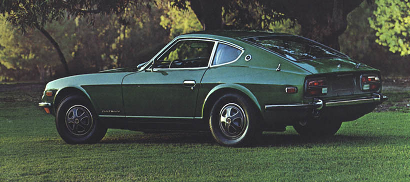

Remember that the 240-Z's were Sports/GT's... with all independent suspension. Lots of ground clearance, lots of spring/shock travel. In stock form they aren't supposed to be sitting on the ground..
Note Picture of Stock 240-Z below - see the ground clearance in front.... see the tire/wheel arch clearance in the front.
