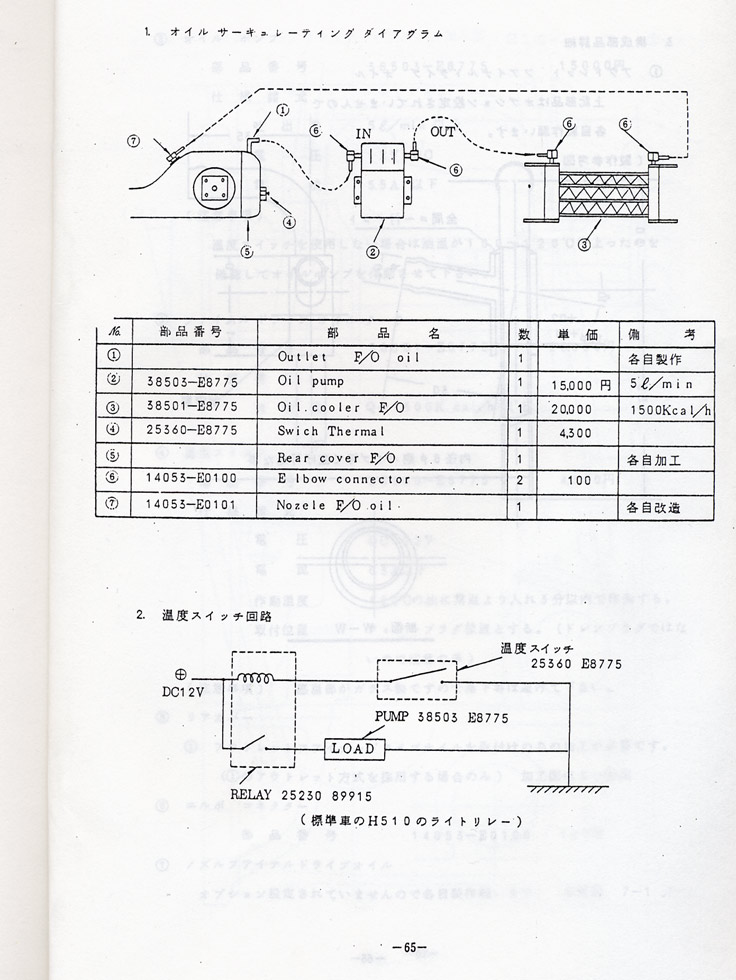

The Factory race prep manual for the S30-series Z carried information on their recommended diff cooler setup. See scan below.

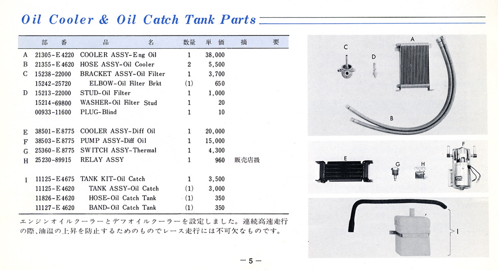

Parts were sold to the general public through the Nissan Sports Option catalogues. See scan below.
In Works rally cars, the pumps were most often mounted inside one of the 'tool bins' behind the seats.
The diff coolers sold in the Sports Option catalogues measured 70mm x 200mm x 40mm, and the pumps were rated at 5 litres per minute.
Alan T.
