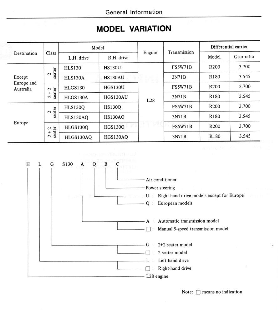

Unfortunately you reply doesn't answer the question that I poised.
" Did the LHD S-130 have an L in it's model prefix"?
Call me stupid if you like, however I can't find any reference to LHD export models to the US in your reply, else it's become so completely buried in the thread that I've missed it.:stupid:
Arne suggests that the L is included, however is unsure.

Zedrally,
I am perfectly calm.............. ( the Prozac is working wonders ).
I thought I made it quite clear which question I was answering in my reply ( The 'H' prefix one )? Any frustration you may have noticed in that reply would be due to the fact that you are asking questions in this thread that I attempted to answer for you in the other - and you don't seem to have paid attention. The 'H' prefix WAS used in the Japanese domestic S130 lineup, and wasn't 'reserved' exclusively for the Export models.
You asked a few other questions too ( unless you were just thinking aloud ) - notably about the 'L' prefix in LHD Export S130 models, and hopefully this scan from a factory S130 workshop manual might go some way to answer a few of them. See the attached file:

Thanks Alan,
Prozac does a wonderful job, doesn't it!
The attachment answers the question perfectly.
It also show the inconsistancies within the Prefix system.
In future, I promise NOT to use the system used in one particular model to another model type.
