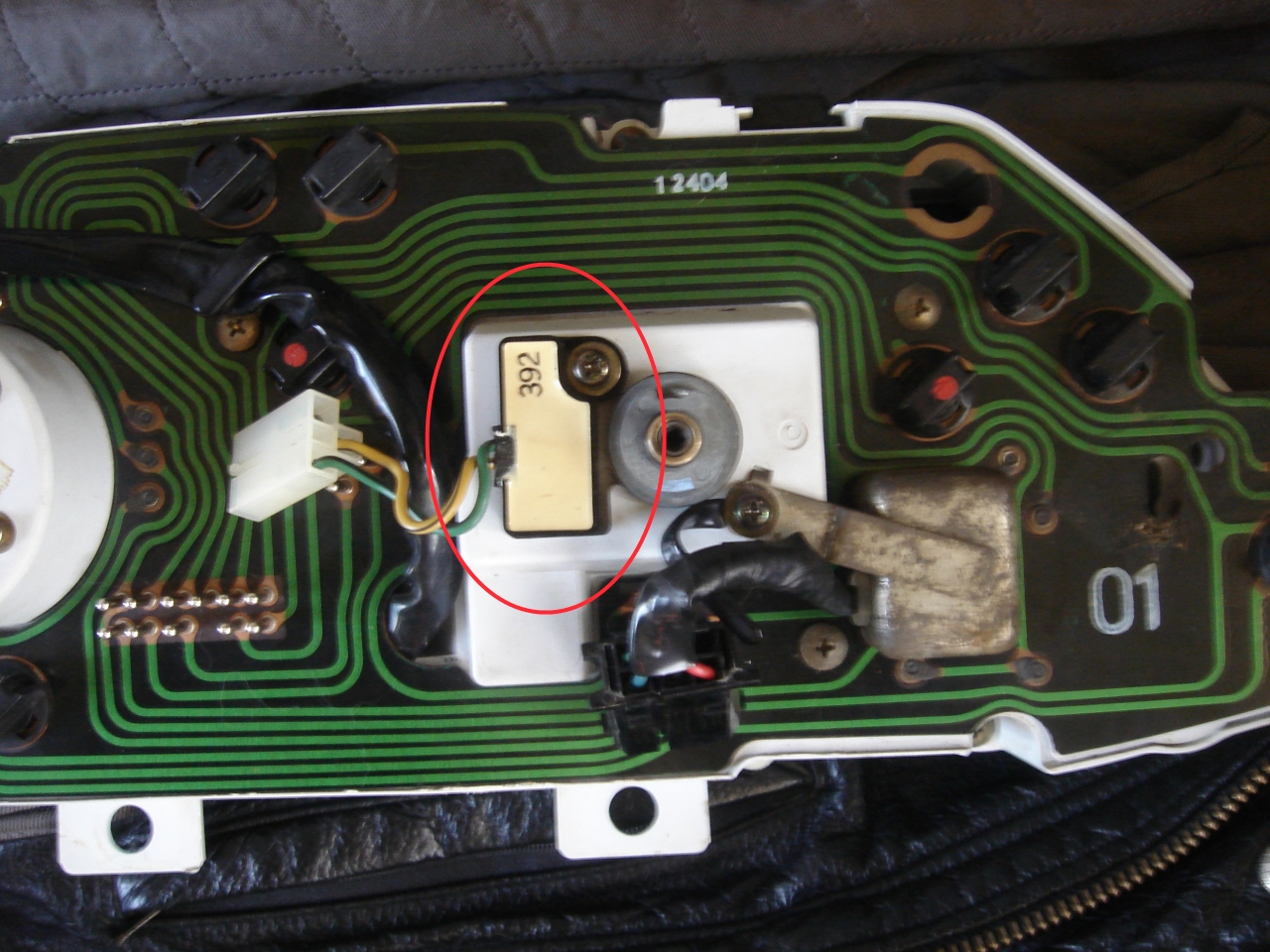

I found the culprit regarding my broken speedo cable. In the attached photo I have circled a sensor that seems to creep into the cluster over time. It doesn't take much movement inward to block part of the mechanism inside. It seems that this blockage is what was causing my particular problem- I figured this out only after one had broken in there (good thing I had a spare). I found a couple small washers to fit, and this should fix the problem (I'll know once I order another new cable).
