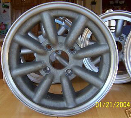

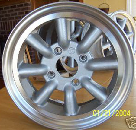

I picked up a set of 14x6j type B wheels some time ago, Dan. They are very nice. You mentioned considering a type A wheel. Thought I would post pictures of the difference. Eiji was a huge help to me when I bought my set. Helped me get lug nuts and center caps.
Thanks, Chris. I think there has been some confusion about the differences of type A & type B wheels. I had initially thought that
it was the difference in design of the spokes as shown in your two illustrations, type A being the right picture where the spokes stop
on top of the rim, and type B being the left picture with the spokes continue down the sides of the rim.
Then, after reading some of Alan's comments here and other gleaned information, I have concluded that the difference between
type A & B has entirely to do with the different offsets available, A being lesser offsets and B being greater. What do you think?

What do I think? I think I have my 'A's and 'B's mixed up! And I also thought it was a spoke style issue but what you point out, Dan, is perfectly logical. So I guess I have to admit that I don't know squat about all this high-tech offset and backspacing lingo!
So, I went out to the shop and measured mine. Turns out I have 14x6.5j type As! Surprise! I have Toyo Spectrum radials mounted - P185/70 R14s. Some time ago, I loaned my wheels and tires to a friend (280Z) while he had his wheels done. No issues. I'm going to have to read up on the offset explanation, evidently I don't understand what I think I do, however my roughly measured backspacing ( back of center plate to rim edge ) is roughly 105 mm. Does that help?
I'll change the titles on my pictures!
