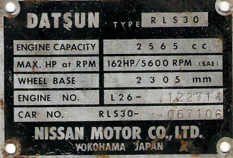

I have a question about horsepower. From what I ve read the stock hp of a 1974 260z is 139? On my 260z the plate under the hood says hp is 167 or 169. Whats up with that?

Maybe you mean 162? Here's a 260Z plate. And to answer BuDavid, Datsun didn't use net hp ratings until the 1979 model year.
Ok 162 but why?
I think I answered that in my last sentence of my last post. 162(gross) vs. 139(net) in other words, prior to 1979 they were rated at the flywheel after that they were rated at the rear wheels.
