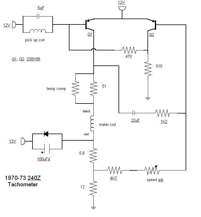

I have an early tach schematic I will post after I get it scanned. It’s just a very basic two transistor astable (one-shot) multivibrator circuit that drives the meter coil. The transistors are type 2SB189 (PNP 25V 250mA). Looks like you can still get them: http://www.ceitron.com/semi/ceitoshiba.html

The tacho which was installed until late '72 (also called 'four wire tacho') is current triggered, e.g. it measures the current going to a small wire loop in the +12V feed to the coil. The current is picked up by a small internal coil and then amplified by two germanium transistors (see circuit by zcarnut above).
Unfortunately, this setup will only really work with an inductive points triggered ignition setup with less than 4A primary current. With a modern transistor ignition you would need to recalibrate the tacho due to the higher primary coil charge (typically 4-8A). A CDI or EDIS setup wont work at all, as in a CDI setup there is less current but a much higher primary voltage, and EDIS uses a wasted spark setup with multiple coils.
