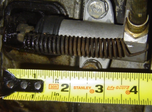

I need some info on the return spring that mounts on the clutch slave cylinder. Not sure which cars came with this, but the early 240Zs did at least. I'm almost done gathering my parts to swap in a Type A 4 speed instead of the factory automatic. But I don't have that spring, nor do I see it available anywhere (catalogs or websites). Can anyone give me the dimensions and approximate tension rate on one so that I can look for an alternative?

Hey, Arne, I will try to get you a measurement tonight, maybe a pic.

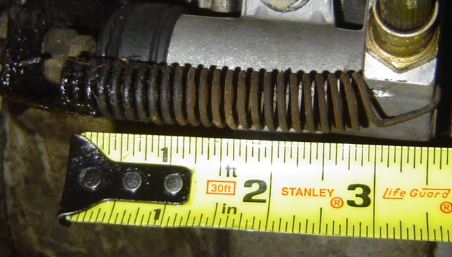

Here you go Arne!
As far as I can tell, the unsprung length of the SC spring is around 3 1/2 inches(out-to-out), and the diameter is about 1/2-5/8. I had to drill a pilot hole in the casing of the SC because this VB part didn't have a way to attach the spring.

I just purchased an aftermarket slave cylinder today. The new cylinder does not have a flange with the hole for the spring. I noticed on the pictures above posted by Mat that his does not appear to have this flange on it. Can anyone give me some guidance on this? I have a 72 240Z 4 spd mfg 3/72. Do I have the wrong slave cylinder?
