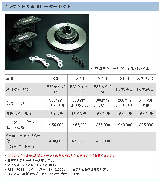

Several of the Japanese tuner stores for our cars sell CNC brackets for adapting the Z32/R32 calipers to our stock uprights and use off the shelf rotors from other cars.
For example, GritTune in Kawaguchi (Saitama Pref. North-west-ish of the city):
http://www.grit-tune.com/
If this doesn't spell it all out... what rotors to use, what size wheels, etc..
Check the attachment... i am going to try to get a pair of the brackets when i go there next month
-e

would love to get the info out of that email about the differences.. i still have my Z32 NA calipers so if there is little difference, it might be better for me to revert back to them (they are certainly lighter and bigger though) and try and get hold of a set of the adaptors from grit-tune
pm me if your interested in the contact details of the guy in Australia selling me the watanabe's, i have the size drawings here too, just need to scan them in (and decipher them :))
I'm thinking about springing for the 55000yen disc/adapter package listed for S30 when I'm over there... So at least I can use it right away on the car, and then start looking for some replacement brake discs available in the USA that will match that 300mm diameter one their kit comes with...
I can't exactly go down to my local nissan dealer and ask for another set of front R32 TypeM brake rotors...
I had asked a friend to inquire if they sold the adapters separately - they do and at 22000yen as I recall... If you search on Yahoo Auctions you will see similar adapters pop up here and there as well for usually the same amount of money...
