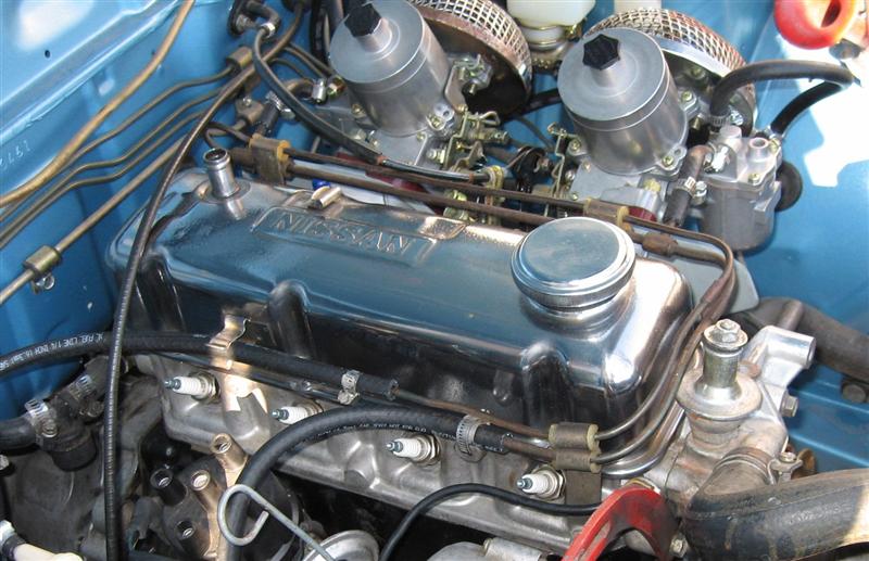

Posted March 2, 200619 yr comment_157823 This is the 210/B310 I'm working on. See anything familiar?? Link to comment https://www.classiczcars.com/forums/topic/19072-recognize-anything-in-this-pic/ Share on other sites More sharing options...
March 2, 200619 yr comment_157829 Flat Top Carbs? Link to comment https://www.classiczcars.com/forums/topic/19072-recognize-anything-in-this-pic/#findComment-157829 Share on other sites More sharing options...
March 2, 200619 yr comment_157835 Well its got a engine.... Link to comment https://www.classiczcars.com/forums/topic/19072-recognize-anything-in-this-pic/#findComment-157835 Share on other sites More sharing options...
March 2, 200619 yr comment_157836 Please don't mistake those for the horrible Z car flat tops. You're looking at the GX SU set up for the "A" series motor. A very desired and sought after set of components. Notice the float bowls are much like the round top SU's. These are very good carbs. Link to comment https://www.classiczcars.com/forums/topic/19072-recognize-anything-in-this-pic/#findComment-157836 Share on other sites More sharing options...
March 2, 200619 yr comment_157838 I have seen one of thease cars at a auction before if im not mistaken. Went for 15 grand Link to comment https://www.classiczcars.com/forums/topic/19072-recognize-anything-in-this-pic/#findComment-157838 Share on other sites More sharing options...
March 2, 200619 yr comment_157839 I'm not sure what he's after but yes, those are flat top carbs but not the 240/260 type. They're the 38mm GX/SU non-smog flat tops. They were a production line option on RHD 1200's/B210's. The manifold and carbs were once available through Nissan Motorsports. Michael, do you have the GX cylinder head also? Link to comment https://www.classiczcars.com/forums/topic/19072-recognize-anything-in-this-pic/#findComment-157839 Share on other sites More sharing options...
March 2, 200619 yr comment_157840 I have seen one of thease cars at a auction before if im not mistaken. Went for 15 grandOne of what cars, Bill? Link to comment https://www.classiczcars.com/forums/topic/19072-recognize-anything-in-this-pic/#findComment-157840 Share on other sites More sharing options...

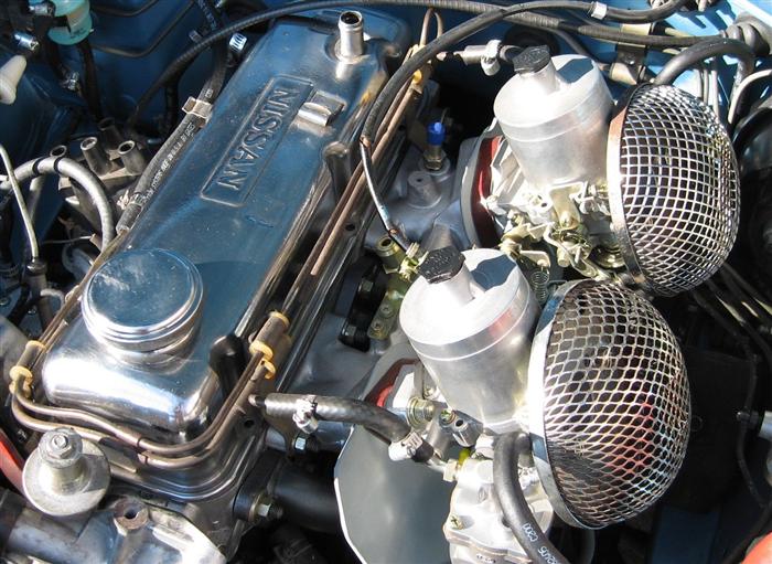

March 2, 200619 yr Author comment_157841 Right Victor. Still haven't spotted what I'm asking about though. Here's another pic. Link to comment https://www.classiczcars.com/forums/topic/19072-recognize-anything-in-this-pic/#findComment-157841 Share on other sites More sharing options...
March 2, 200619 yr Author comment_157842 Hi Stephen. No GX head, just the stock B310 head that came on my car (reworked though). Mild Isky cam, rebuilt block and these are ZTherapy Carbs by the way Custom linkage and head shields courtesy of ZTherapy, and header from down under. Ready to install a Roadster choke, finish a few electrical details and start her up. Engine has been down for more than a year now - I just need time to work on it! Link to comment https://www.classiczcars.com/forums/topic/19072-recognize-anything-in-this-pic/#findComment-157842 Share on other sites More sharing options...
March 2, 200619 yr Author comment_157844 A clue - it's a stock 240Z part in a prominent position in the pictures. Saved me quite a bit of work on the installation. Keep in mind I went from a single carb to duals... Link to comment https://www.classiczcars.com/forums/topic/19072-recognize-anything-in-this-pic/#findComment-157844 Share on other sites More sharing options...
March 2, 200619 yr comment_157845 I know it must have to do with the fuel lines or linkage, but since I've dealt mostly with efi cars of late, I can't remember exactly what the 240Z setup consists of. About the GX head, the rocker arm oil passage had to be modified to fit it on anything other than a A12. I doubt if you could even find one now days anyway. Link to comment https://www.classiczcars.com/forums/topic/19072-recognize-anything-in-this-pic/#findComment-157845 Share on other sites More sharing options...
March 2, 200619 yr comment_157846 Fuel rail.....without a doubt. ChrisP.S. Sweet motor Michael. Link to comment https://www.classiczcars.com/forums/topic/19072-recognize-anything-in-this-pic/#findComment-157846 Share on other sites More sharing options...
