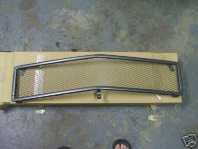

Got the grill and am in the process of trying to shoehorn it into place. I know some slight "mods" need to be done but am curious what anyone else who's got a grill in a later 240 did to get it in there.

Would this be the one?
That's the one. When I originally bought it I thought it would fit any 1st gen Z but when I did a search here to see if I could find some pointers for putting the thing on I read a thread that said for post 7-72 there would need to be some "mods" done to get it to fit. It doesn't seem like it fits at all, too wide, but I may just have to use the bodyman's 3rd best friend and a little physics to get it in there.

Anyone who's stuck it on a post 7-72 240 can chime in now to tell me if they had any problems mounting it or what they modded to get it to fit.
went straight on my 260,but it sits about an inch too low,to make it look and fit you will have to get 2 bits of metal,drill 2 holes each end so as to lift it up a bit then it will look a lot better,still have to do that to mine,been a bit cold here in england but it is a straight forward job
