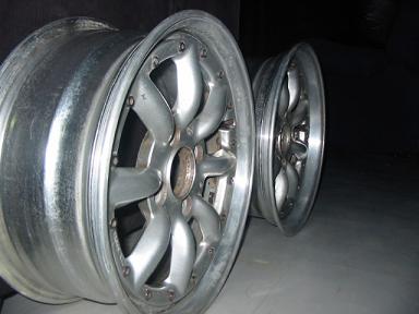

Then I guess you've just solved your problem. Haha! Don't know why the previous owner did that kind of setup.Different strokes for...you know the rest. If you have the time try removing both the front and rear springs and compare them. Not sure if the "R" stand for rear or right side? Maybe the other members who know better about the suspension setup for the Z can help you out but yes, the rims do make the car! I love it. Are they the Panasports? The rear rim looks more incised than the front? I have something similar to those but still having them reconditioned.

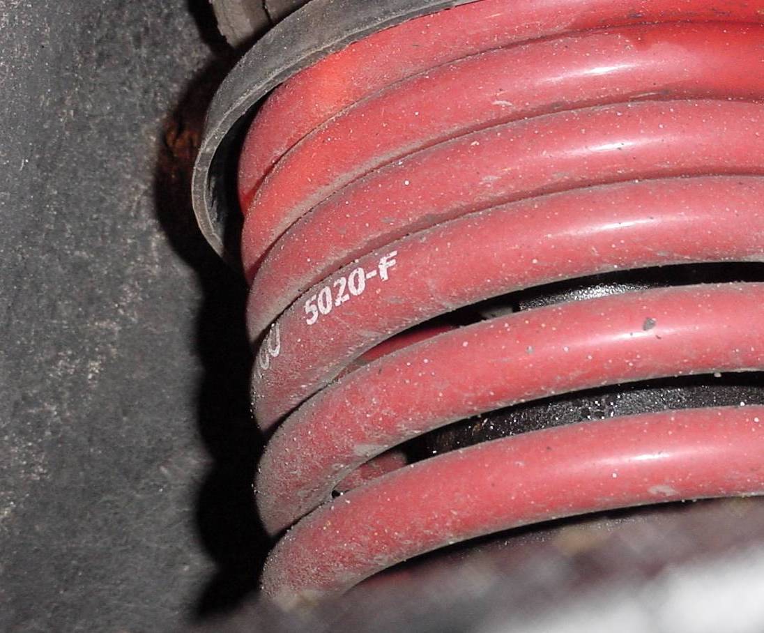

FYI, The R does stand for "Rear". If you can read it, the attached pic shows my front Tokico spring. It reads an "F" after the part number. Hope this helps!
I believe Tokico says their springs lower the car 1" from stock, but from what Carl Beck has mentioned, the US spec spring did leave the front somewhat higher than the back. That is why Courtesy Nissan is now selling Euro spec springs. (Mine arrived today BTW!)
