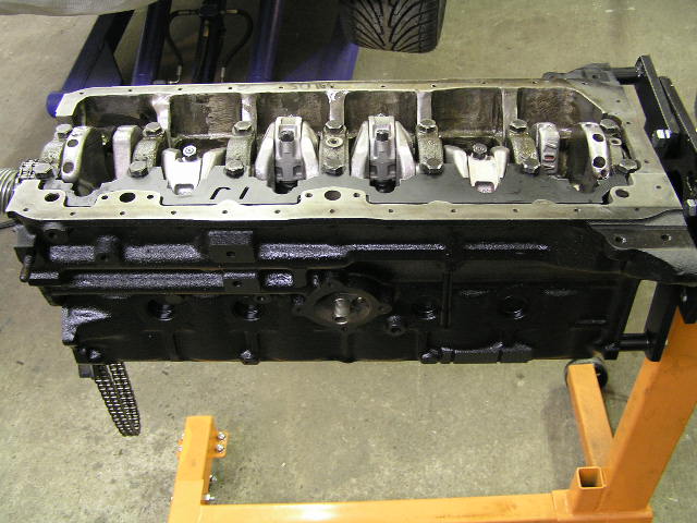

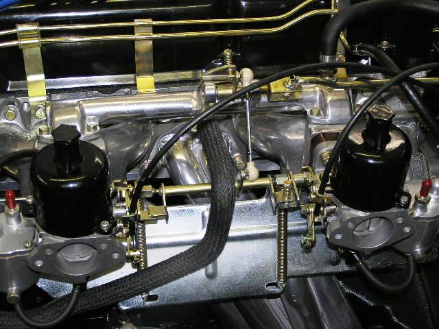

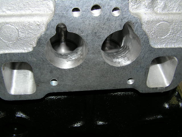

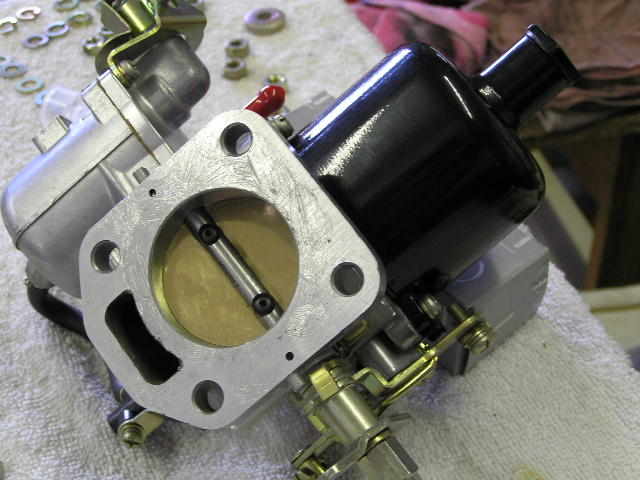

I have a 2995cc engine in my '71. It has the LD28 crank, 240Z rods and Z22S pistons. The machinist had to maching the top of the piston because it sat above the block. I have a P90A head and have a compression ratio of 9.0:1. I am presently running ZTherapy SU's with a stock turbo camshaft. I just received a .480 lift/268` duration hydraulic camshaft for it. I will see how it performs with the new cam. I have plans for getting a bit more flow into the head. It now has a LOT of torque and spins very well to 6500. The short block was built by Hatch Engine Service. They also ported the P90A head/intake manifold and did a trick valve grind. I am very pleased with the performance of this engine.
Hi ZSaint, nice looking motor. Can you tell me if the crank scraper is held down by the main cap bolts? Looks to be, I'd like to put one of these on my Z but don't want to drill and tap ANY area for the scraper hold downs.
Thanks in advance,
Chris A.
