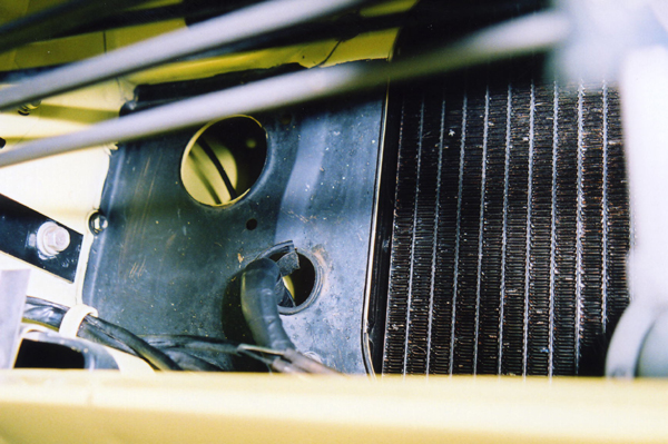

Oh my! I didn't see this thread until now. All S30 chassis front radiator supports were brush painted flat / satin black. Now, I'm going out on a limb by saying that because I have come to learn that as soon as you establish something consistant about the S30, you find the exception. So except for the exceptions, the front of the radiator support is brush painted black. The picture you posted, Ed, is the car I associate with Harry Figg? - an exquisit over restoration.
Here is a picture of the area from an early 1970 build with 23,000 original miles from the national convention.
Your correct Chris about the picture. I used this as reference. Hope he doesn't mind. Reason I started this thread is because my car didn't come with the black paint. (110 Red).
That guy called in sick that day!
Some day, we'll have a true concours system, and you'll get points deducted if the area is not painted or painted too well

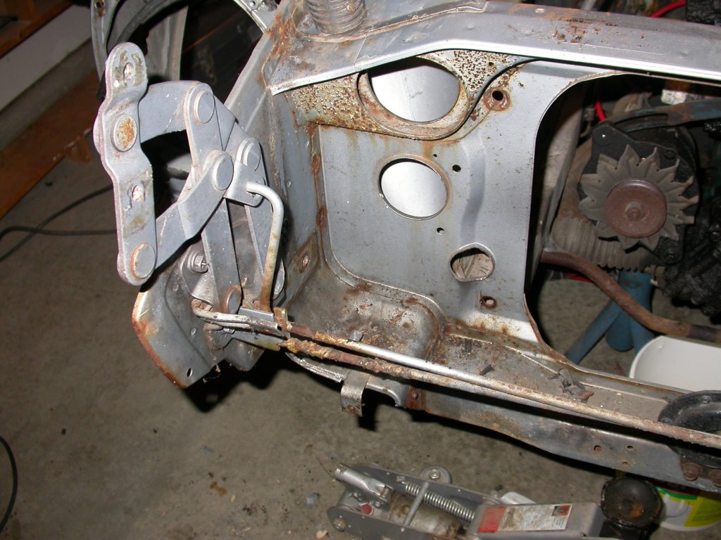

Chris, does #26 have the paint? #215 does NOT, but I know that the car was repainted the original 901 silver. I know that some of the engine bay was (badly) painted, but the front of the radiator support looks original compared to the areas that I know were repainted. Pic attached...
Mark, I'd guess that the front of the radiator support on #215 was also repainted. Just a guess, as the hood springs are painted silver, too. They should be black. Not conclusive, but a good indication. :geek:
I don't mean to be nit picky :paranoid: , but like you say, not a good paint job in the engine bay. I mean, jeez, the paint code label was painted over! :tapemouth
I thought the hood hinges were unpainted, just had the cadmium plating, that's the way mine are. BTW, my radiator support is painted black. Original body color 905 red.
